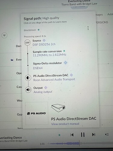

Send a screenshot of your Signal Path when playing DSD256. It might provide an answer. I likely can’t provide it but someone else might! Good luck
Dave

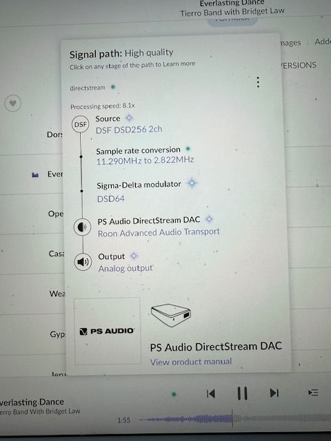

Hi Dave here is the screen shot:
Roon appears to be doing this, not AirLens

Underneath Airlens what do pins 3 and 4 look like - both should be ON for DSD 256, you might need to check pin 5 for native vs DOP also
Does your MK1 have the Bridge card installed and if so is it still connected somehow? Try removing and re-adding any and all audio zones in Roon.
All the pins are up on the Airlens. I have not removed the bridge card on the MKI yet, to try .
