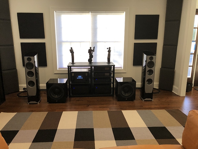

The inside heat sinks of my 300s run hotter than the outside sinks. I use to have solid side panels and mesh doors on this stand, the amps & P20 ran a lot warmer then.
That is a beautiful setup.
