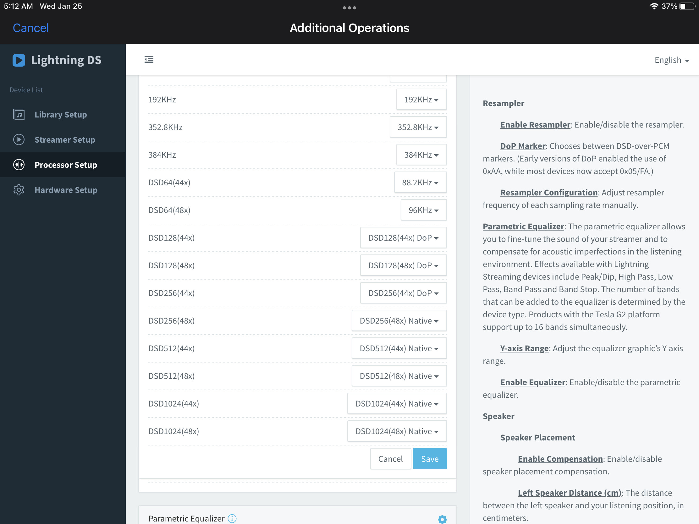

I have a mk2 I’m borrowing from a forum member. I also use a wireworld USB out of my Aries G2. I had the USB running to my matrix with I2S out no issues with mk1. When I ran the usb direct to mk2 I couldn’t get it to play DSD 256. I went in the setup menu on the Auralic under processor setup go to resampler. Mine is set to off. Open it up and make sure your DSD settings are set to DOP. My 256 was set to native when I switched it to DOP I was able to hear DSD 256 thru the MK2. I hope this helps.
