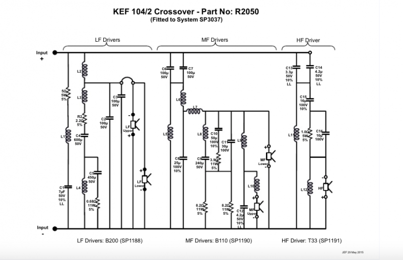

KEF 105/3 Crossover :frowning_face:
KEF 104/2 Crossover :frowning_face:
I understand the need for higher quality Caps in the signal path be it Preamp or Amp but in the Speaker Crossover, it can get VERY expensive depending on the complexity.
Yikes - That can add up quickly.

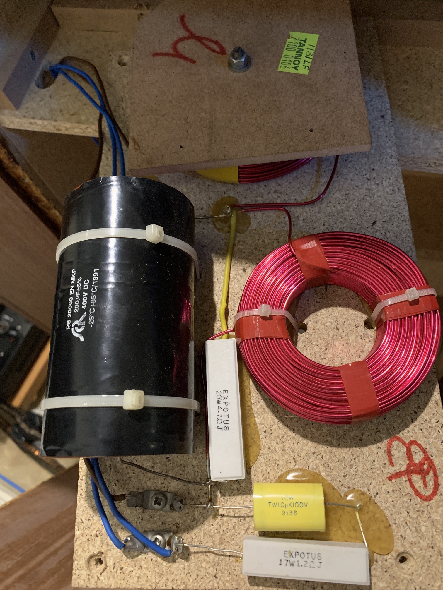

I completely rebuilt the crossovers in my Tannoy Westminster speakers. I used Miflex capacitors, Mundorf inductors and Duelund resistors. Worth every cent I spent.

So, here is the original low frequency crossover. That yellow capacitor is maybe 2" in length.

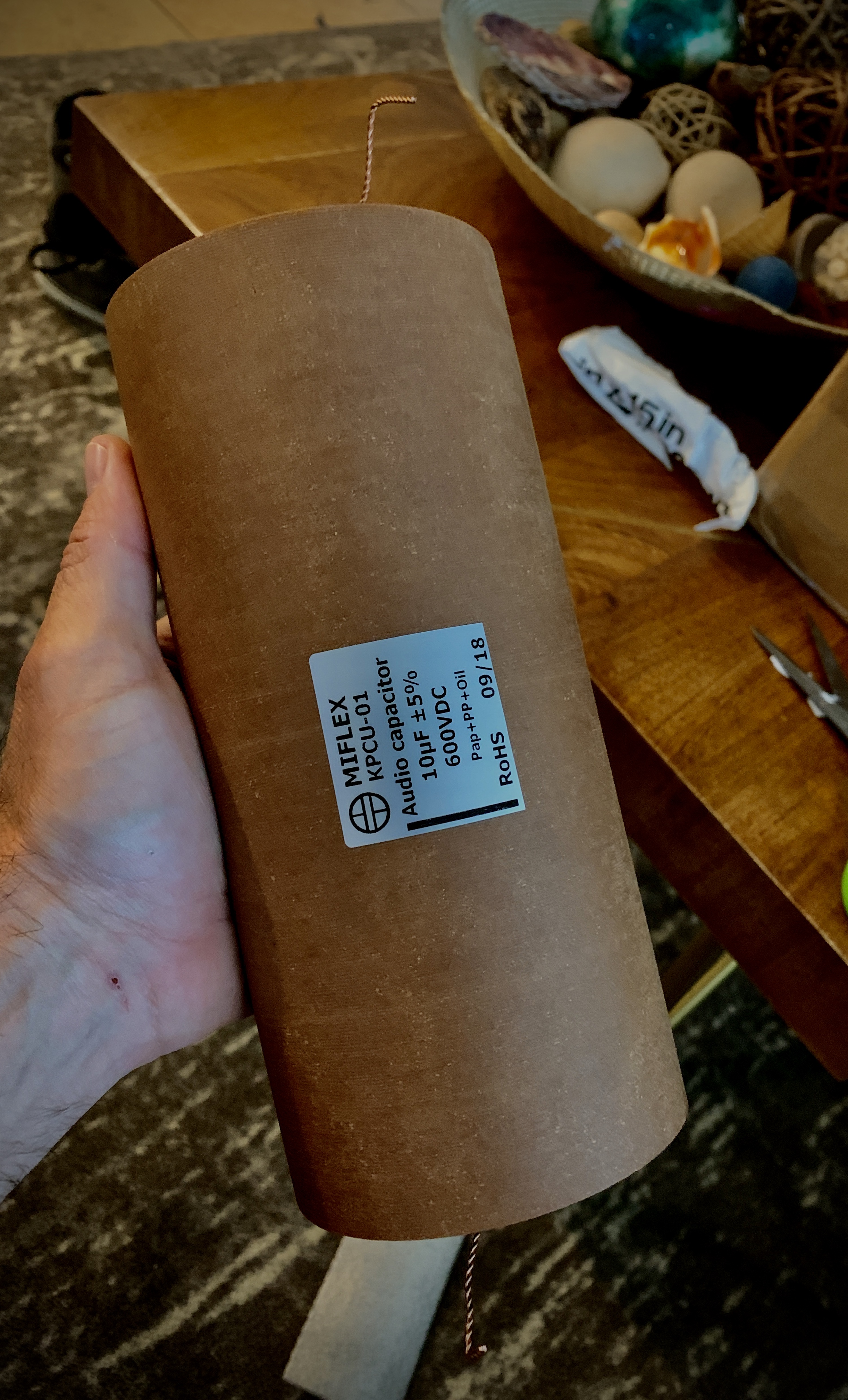

And here is the new Miflex cap that replaced it!

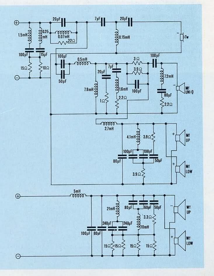

Using old KEF Magazine reviews, I found the measured KUBE curves for the 104/2’s and the 105/3’s. The Cavity Coupled Woofers have the curve inline with the Crossover as opposed to bypassing the Woofer X-Over altogether (which worked fine)
I would love to rip out all those X-Over’s and just go miniDSP with an inline BOSC amp feeding each set of drivers. These GaN Amps run absolutely cool. I could mount both the miniDSP boards and the BOSC Amps inside the bottom of the Cabinets (where the X-ver’s are now. I could probably cram the recommended power supply (https://www.mouser.com/ProductDetail/Murata-Power-Solutions/PQU650-54?qs=BJlw7L4Cy79D6Ol1v2EeAA%3D%3D) into the base as well.

Capacitors that size are crying out for an external crossover enclosure!

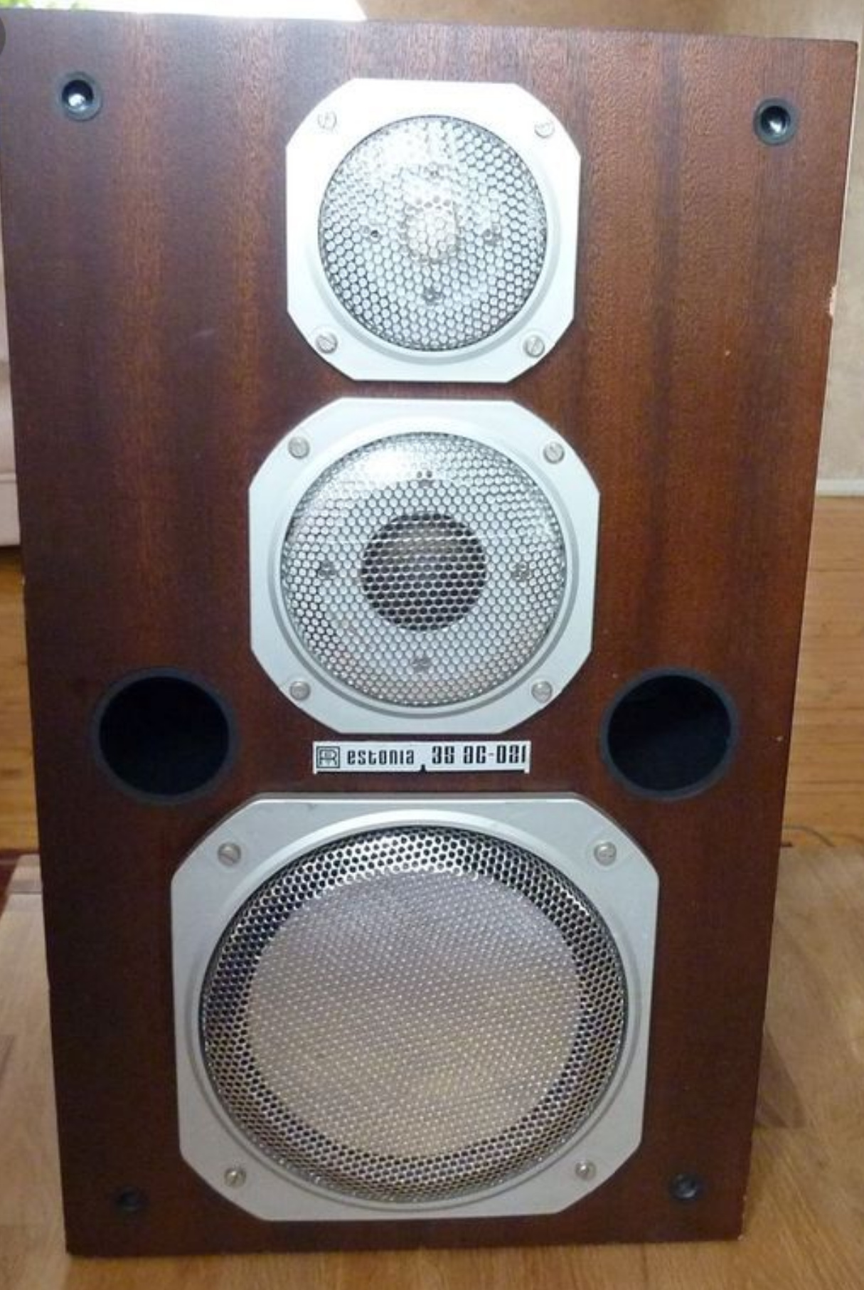

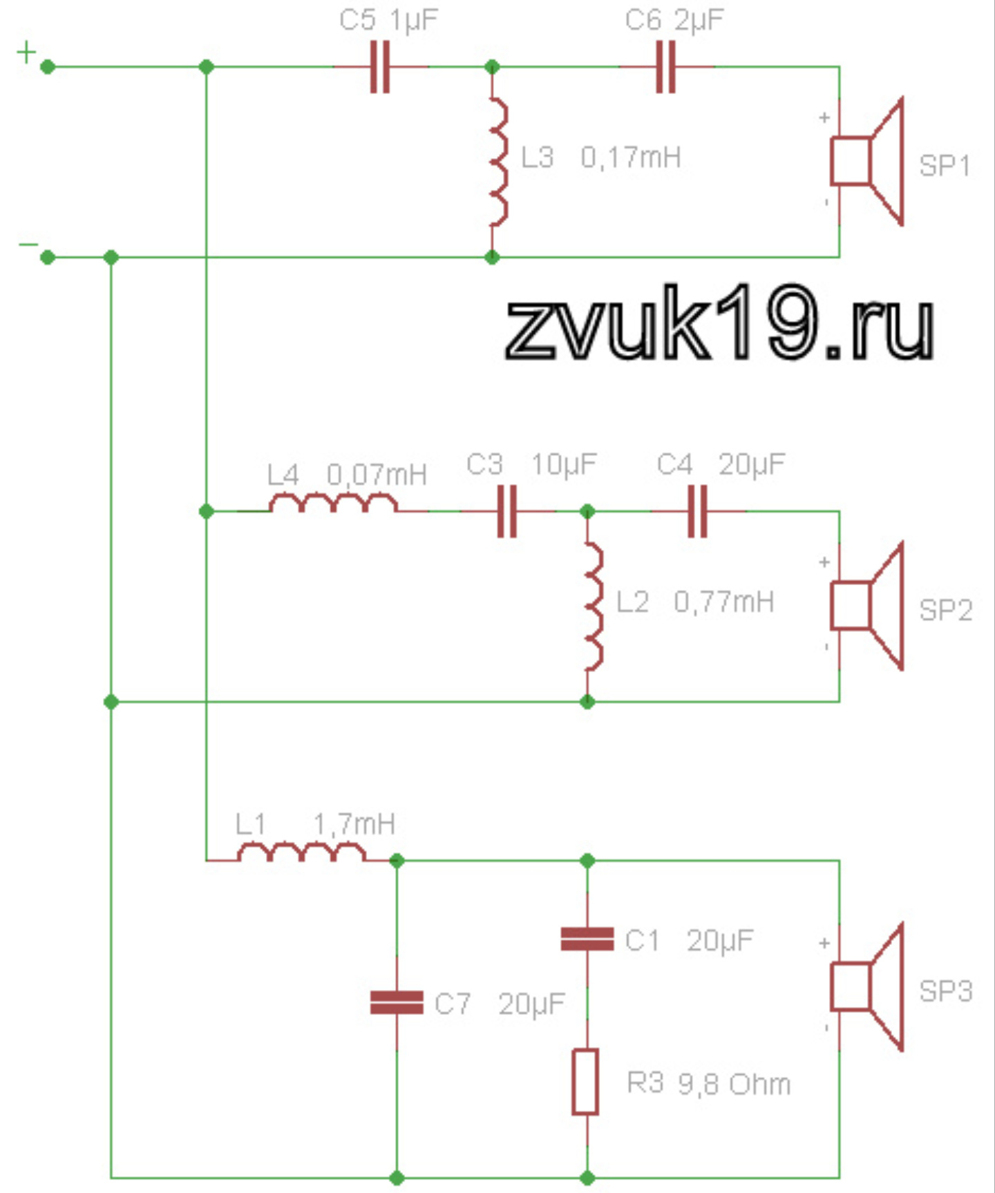

Can someone please give any kind of comment on how “well designed” these aftermarket crossovers for my '78 USSR speakers are?
(RET Estonia 35AC-021, but I doubt anyone’s heard of them)
I know, might be hard to say, but I’ll provide all the info and pics I can.
8ohms
35-50W recommended, 100W power handling
25Hz-30kHz (kinda
Double front ported
6.5" aluminium sandwich flat woofer
2" stiffened textile mid dome
~1/2" silk dome (?) tweeter
Internal volume ~1.55 cubic feet

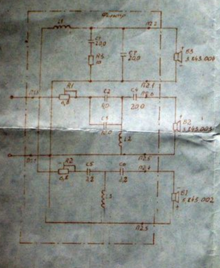

New crossover diagram:

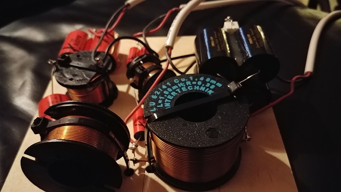

New crossover built:
Old crossover diagram (blurry, was hard to find):

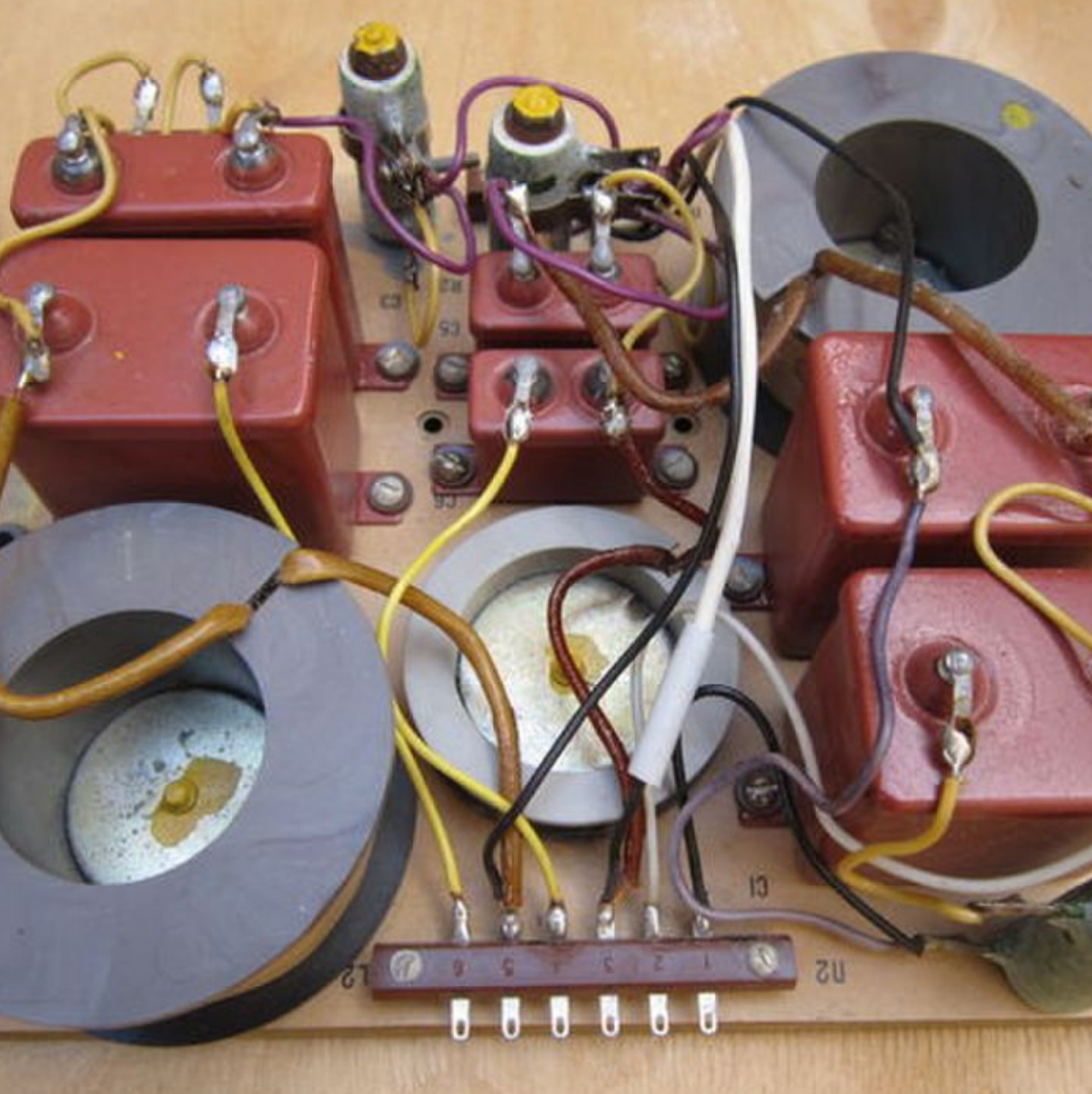

Old crossover:
Obviously the new ones are built with modern mid-to-high quality parts like PP caps, etc. Audyn caps if that says anything. Very nice Black Rhodium cabling. (I asked for quality parts so I guess they are. Weren’t cheap)
Based on all this, what can I expect in improvements? Haven’t installed them yet. The design was by a Russian guy who actually was pretty devoted and even posted measurements, and they’re much simpler circuits, so I guess much better?
Oh, and aren’t they pretty?
The new one looks like a simpler design (and of similar order) so possibly less tailored to the specific drive units, they look like decent parts though and there is a zobel NW on the bass which suggests the equivalent inductance of the bass unit is known, how do they sound?
They look like pretty cool retro design on the outside :slight_smile:
