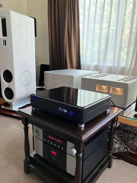

I have been using a preamp since the Massive. I tested in my system as according to your method.
Usually I set the volume of DSD Mk2 fixed at “100” and adjust the volume of preamp during listening.
For testing I adjusted the volume of Mk2 at “50” and raised the volume at preamp. The result is consistent with your report. I could hear the intermodulattion noise which I had been thinking eliminated by inserting the preamp.
So, my earlier thought that preamp may be able to eliminate or suppress such noise is now turned out to be not correct. It seems more likely to be associated with attenuation inside DSD Mk2.
Thank you for your valuable survey.
Meanwhile, I find myself really love my current setup with the preamp (ML No.52) inserted in my system.
Before I insert the preamp, I liked the sound of DSD Mk2 directly connected to Hegel H30 operating as mono blocks. A few days ago I was just curious how it sounds if I connect the preamp to Luxman M-10X power amp. After switched from Hegel to Luxman, I surprised it sounds so much better than connected to DSD Mk2 directly previously. So much better as it even match with 2 Hegel H30s. I know there is synergy in audio since long before but this time the difference is striking.
I really love the sound of the combination with DSD Mk to ML No.52 to Luxman M-10X to FR20. (I even would like to add another M-10X for setup as mono blocks.)
