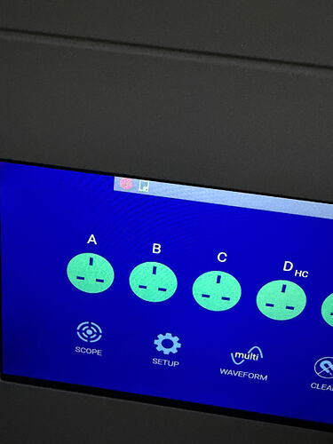

I cannot connect to the internet. The P20 is plugged in to the Ethernet cable and the lights are flashing at the back. But the P20 does not pick up an I.P. Address.
Any ideas?

Tried power cycling didn’t work tried assigning IP didn’t work. But the website control is working on an IP address which does not show on the unit.

System registers itself in the router but doesn’t display the assigned values in the on screen display.
