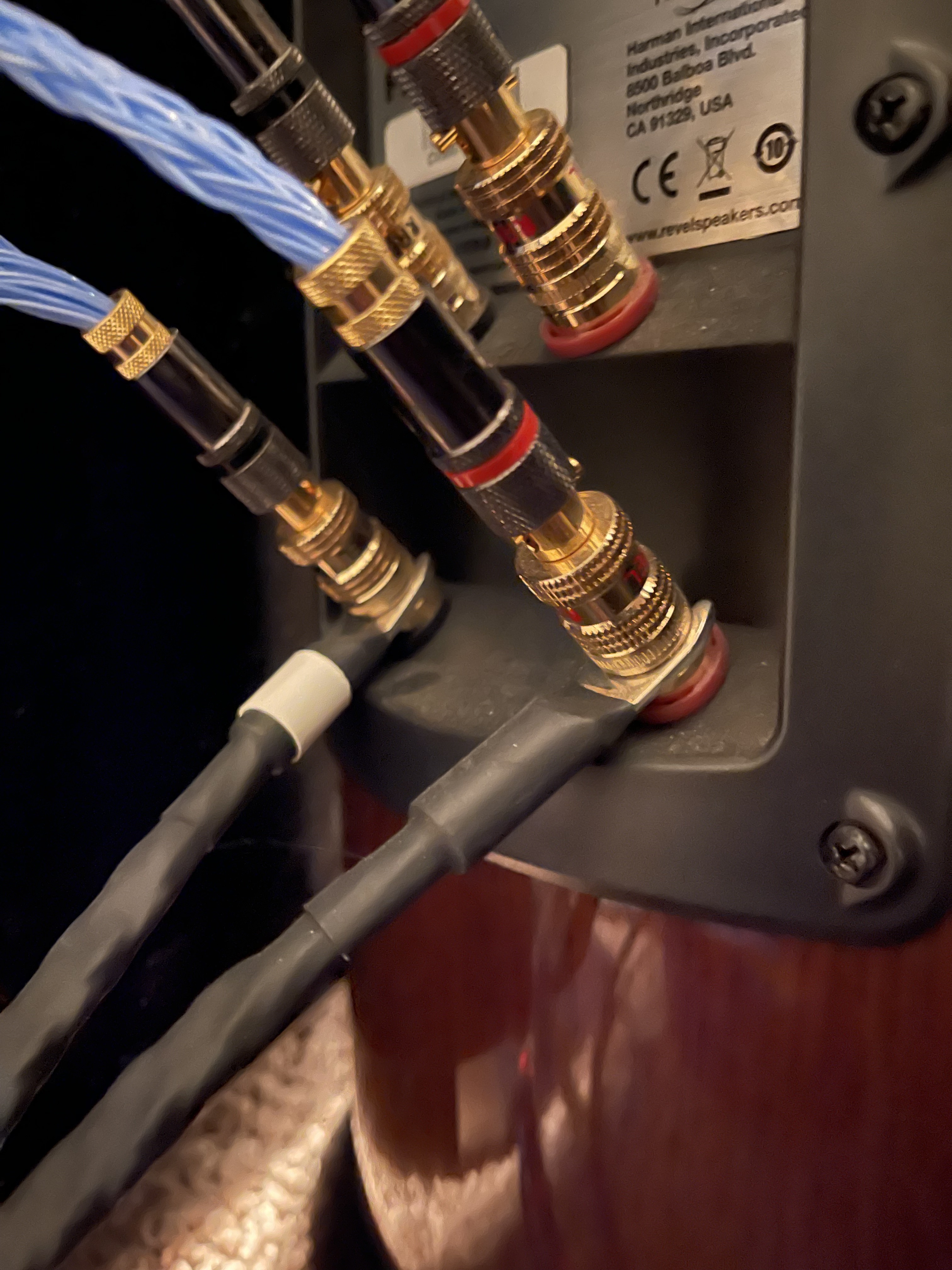

After fixing 2 wrong polarity issues, I still found the bass to be high, I usually kept reducing REL’s hi/low level but yesterday being different, I completely removed both the REL’s and still had the issue…
It seems like the way I have done bi-wiring using the jumper cable in my speaker. Long story short, I use to have the gold plated connector for the binding post but the Iconoclast sales person told their jumper cable is sonically better. It seems I have run the speaker wire to the speakers low from the amp and connected jumper wire from low to high on the speaker :tired_face::person_facepalming:
Now this making the speaker produce aggressive bass. I switched the wiring so that speaker cable goes to high rather than low. Now my dilemma is, if I need the jumper cable or just ditch that and go to binding post connector that came with speaker. Which method do you guys recommend? Or it’s just personal preference?
This was the previous erroneous setup
The jumper cables should sound superior to the gold-plated connectors in any case.
