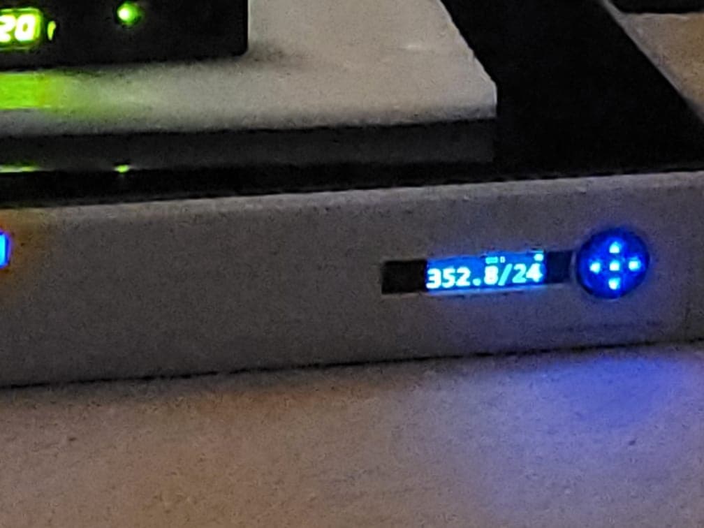

TK DS Mk2 being fed 8x via HQ Player:
I am confused. Why upsample the signal before feeding it to the DirectStream? Isn’t the point of the DS DAC to upsample any incoming signal, on any input, to DSD 256, then go to wideband DSD (20x DSD or DSD1280) before going back to DSD 256 through the low pass filter? It’s also kind of a one-shot deal with a single source, right, you can’t feed your transport’s signal or TV, etc. through HQPlayer also. I hope this doesn’t come across as me picking on you, multiple people here have had the same success using HQPlayer or use something like the Grimm MU1 to feed the DirectStream. It just doesn’t make sense to me. If I were to go the HQPlayer route I’d just get a NOS DAC like the Holo May, possibly even converting everything to PCM to take advantage of the R2R ‘network’.
Why not try it and see. It’s free to try.
Thus also the qualifications about high quality upsampling requiring a lot of compute hp that embedded generally can’t match.
Whatever the case, the DS processing seems to benefit from being fed higher freq sampled data. The Mk1 and the Mk2 IME. Try it and see for yourself.
TK
