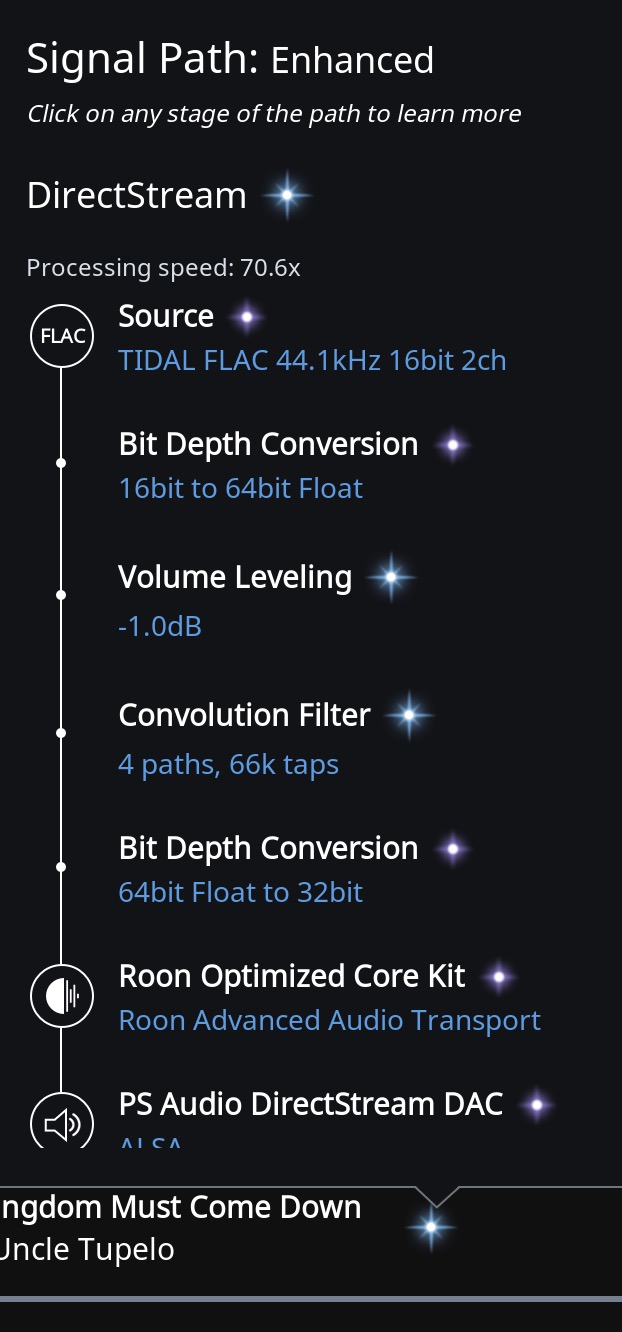

You Roon Core machine could be reaching its limit and can’t keep up, hence the dropouts.
In Roon, if you click/touch the colored ‘star’ icon that shows next to the current track playing, a page will appear that shows the processing path along with a CPU ‘score’. If the ‘score’ is over 100 it won’t show but less than 100 will. You could be down in the <1.0 range and you’ll definitely get dropouts.
Here’s a pic of the little star and the screen that appears.
