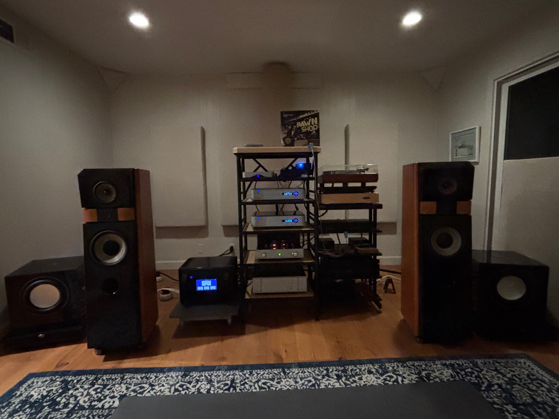

I currently own the FR5 and running a hybrid 3-way active analog crossover to 2 powered subwoofers.

I am already using two independent powered (1200-1500 watts) sealed subwoofers that each have 2 bass radiators.
At first I connected the subs via high speaker level and used the sub’s builtin active crossover.
But using 2 active crossovers (first from the preamp, then the subwoofer’ built in XO) didn’t sound as good as using an analog active 3-way XO that coordinated all three drivers (high, mid ,low) to make them all sound as one.
Also didn’t make sense to me to waste the amp powering the speaker level just to have the subwoofer cut out the unused frequencies; I feel it’s better to only send the frequencies that the sub can play , and use the unused power for more headroom for the other drivers.
my video:
Wow, a hifi 3-way analog active crossover is like an orchestra conductor-- Sublime Acoustics K231
The high-level connection to the amp is supposed to not draw current from the amp because of the impedance of the internal amps in the subwoofers. REL subs are ideal in not drawing current from the amp. I switched from using preamp outputs to the subs to using an active crossover between pre and power amps (with an output to a sub and output to the amp) to using the speakon connection to the sub from the amp outputs and running the main speakers full-range. The last configuration really opened up my system, way more than I thought it would, and is the method recommended by the elite members of this forum
