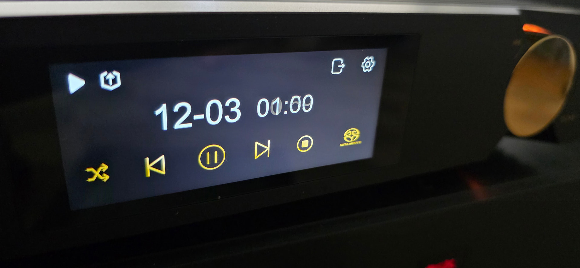

The Shanling display, SACD light illuminated
