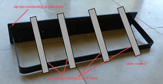

@RTDoherty - I designed and fabled a cable restrainer for my Sbooster plinth so that (4) power cables exiting downward (Z plane), don’t create undue Z plane forces. The trick is keep the cable as loose a you can so the retention factors just a tad in the puck’s function.

@RTDoherty - easy to do. 0.25in steel plate (does not bend and easy to get custom on internet). Bend aluminum (1in X 0.25in) from Home Depot or Ace Hardware in a rounded rectangular C bend. Then tap the steel plate with 1/4 20 tap and screw them together and paint. I used hex head button screws so I could reach the screw easy with Allen. A Phillips screw would be hard to torque cause the C channel will be in the way of keeping the screw driver straight and a short Phillips will not provide the torque I needed and it would be close to the corner (knuckles). I also used lock washers. I affixed it with 4 holes on each side for zipp ties so when I reconfigure rack (20 times to date), I can move. Once I got materials, took an hour and then paint. Trick to bending C aluminum by hand is that each bend use a 2ft level vertically in the vice to make sure aluminum channel is plumb while you are bending by hand or you have lopsided bend, not perfect like you see.
Better pic
Thanks for the info and the picture!
Seems like an effective way to take some of the power cord weight from the rear of the components.
