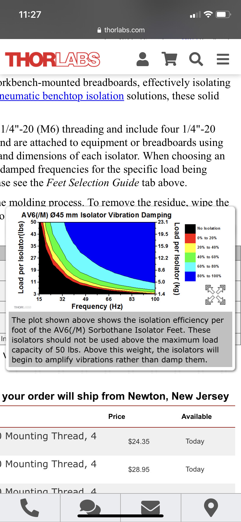

This site gives you a good idea on sorbothane and what happens Sorbothane Isolators. Isoaccoustics have sorbothane inside.
I use the Thor lab isolation under my P20 and mono blocks pre amp and DSD. Gaia Titans for speakers.
