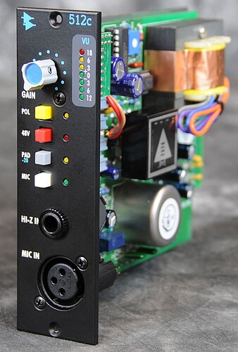

Interesting these same transformers are used in Professional mixing consoles and outboard gear by API and others. Lots of music has been made using API gear. Good stuff! Les Paul used these in his console in the late 60’s / 70’s. These transformers are usually driven with the the famous API 2520 discrete opamp. I use the API 512c Discrete Mic / Line Pre every day in the studio. It uses both the 2520 and this type of Quadfiler 1:1:1:1 matching transformer. No wonder it makes the DS sing.

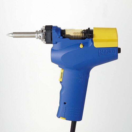

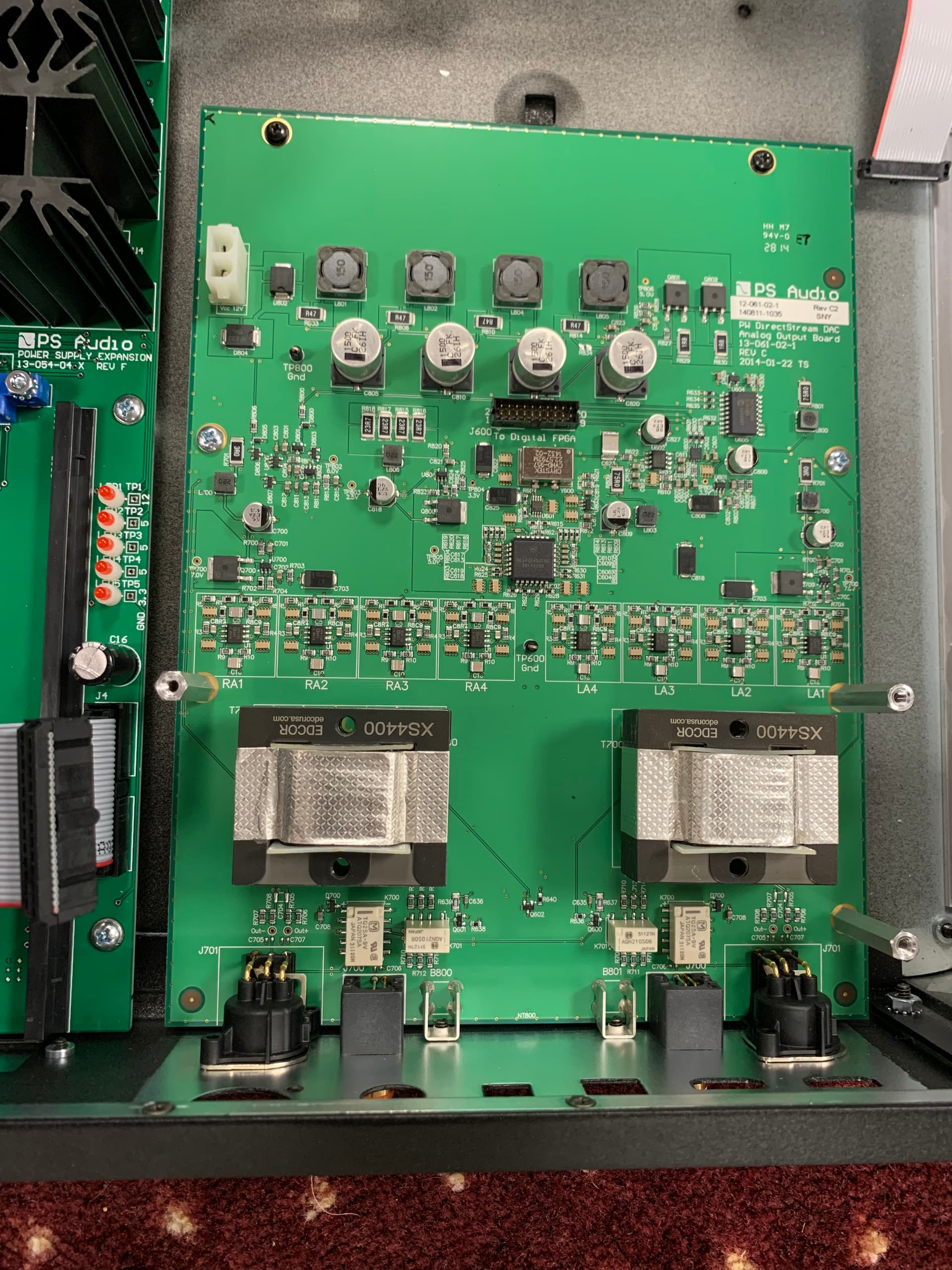

Transformers are installed. Easy job with the hakko FR-301. Received the PW DSD last Sunday. Finished transformer install Today. First impressions… A giant leap in the sound I was hoping for. Larger clearer staging. Thanks everyone here who encouraged this mod.
Just checked out the de soldering tool you used.
A little pricey, but I’m sure it makes the task at hand much easier.
Yes it does. I use it all the time. It took about 3 minutes to de-solder and remove both transformers without damaging the old ones.

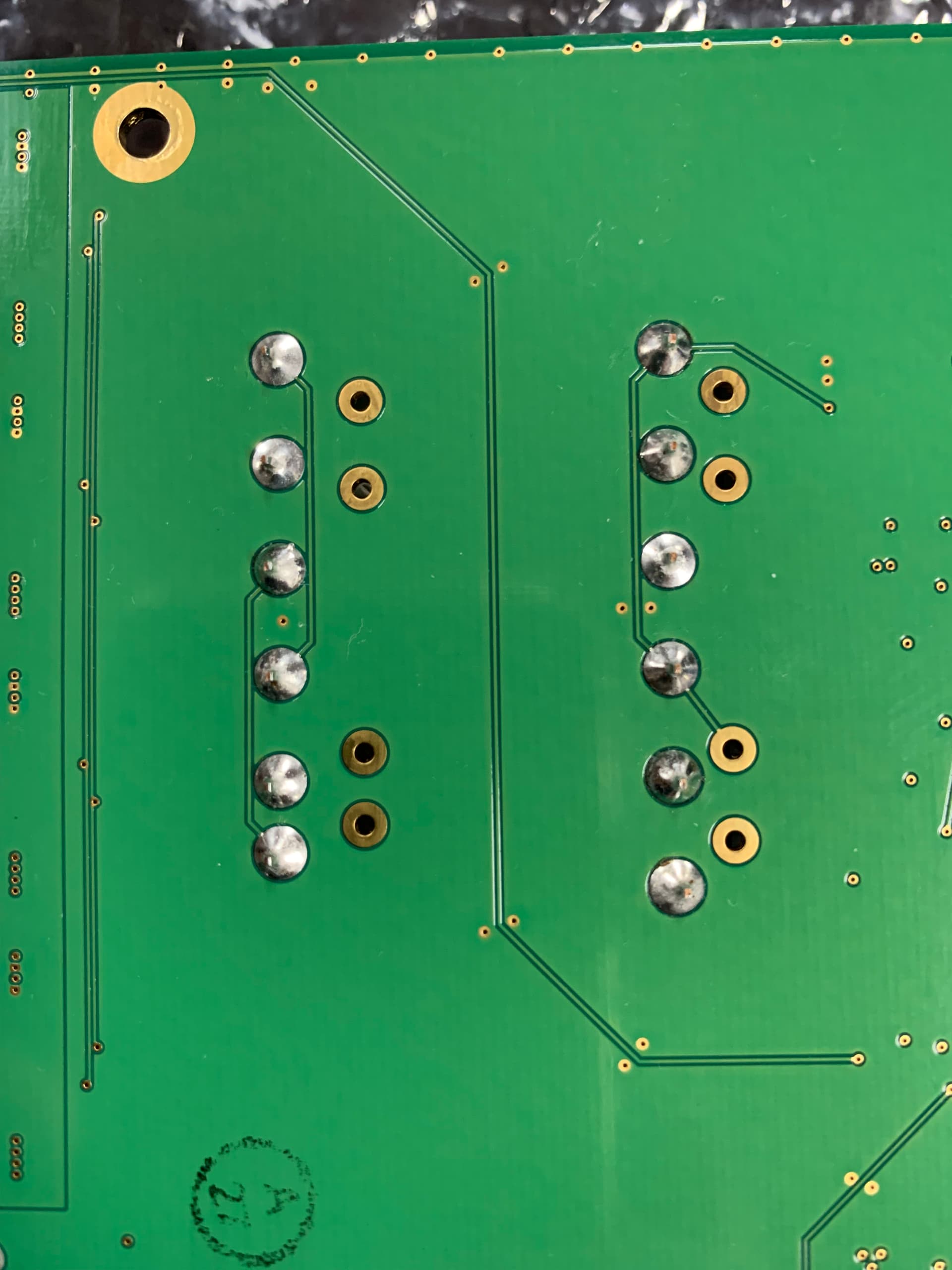

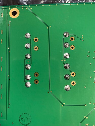

That is quite the desoldering tool. I assume with it there was no need to cut the transformer legs on the installed unit.
Did not need to cut the original transformers legs. The original transformer can be reinstalled if one wants to do so.

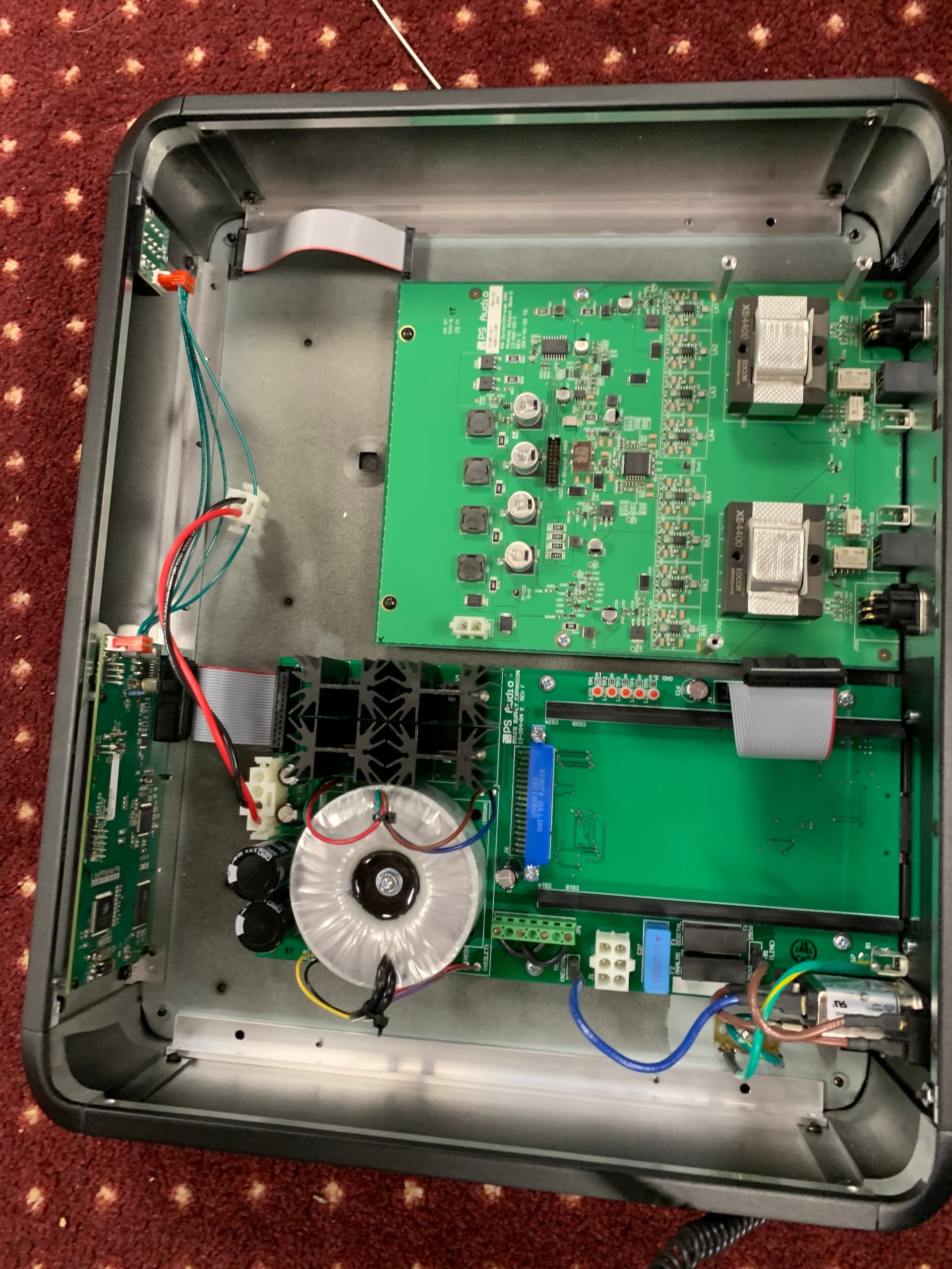

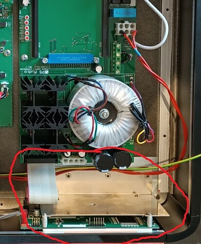

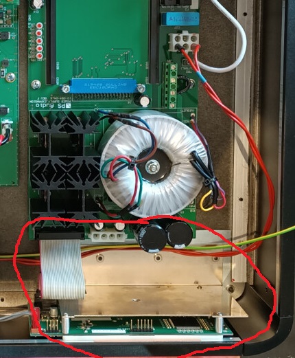

I just realized after reading about shielding behind the display screen that my unit has none. Does anyone else have a missing shield? Seems this is a source for noise.
Yours looks like they all do from factory. Adding shield everywhere Ted suggests is very beneficial as is covering/encasing the output transformers to shield susceptibility to EMI and RF. The additional shielding and external LPS was as big or bigger improvement than just replacing the transformers to my ears.
I see shielding in many photos and videos. Is this something that was deleted? Mine was made in 2014.
Here is what I’m talking about. Is this available to purchase?
Yes…or more important …especially after the transformer mod.
