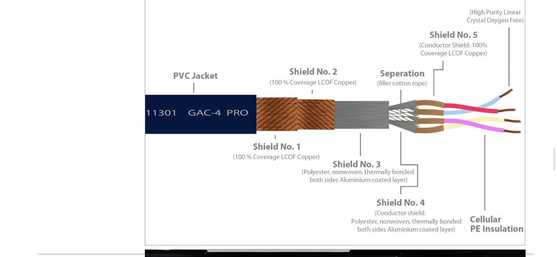

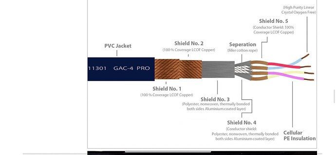

Since I covered all the emitters and susceptible components at once I cannot answer that. I always run with screen off too. I also went with external LPS same mod and installed a 5 shielded DC cable direct from External LPS to DS analog board. It was a step function improvement.
I re-terminated the end of one of these with a board connector after I routed through a drilled bridge block off plate. Since the JSSG360 shield doesn’t need ground on analog connector end, it worked beautifully. My whole streaming network uses these DC power cables. They are stunning for reducing noise in your streaming network.
https://www.ghentaudio.com/part/dc-gac4.html

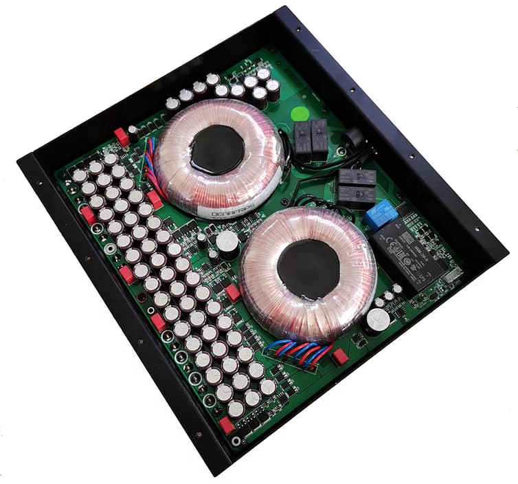

I am thinking about making a base Power Supply like the Denafrips.
Wow that does look impressive withe the super capacitor banks. What are the dual transformer purposes? Would they be needed here?
After reading Jay’s Audio Bacon comparison of LPS power supplies and affects on sound the design seems a function of which one is seeking to achieve. I appreciated he included cover off photos of each LPS.
The big surprise was a simple R core relatively inexpensive design and how much he liked it for some attributes in sound. But the big expensive complicated designs he did seem to like best.
Only one transformer would be needed however I would be using a large 10 amp one and a large very low DCR capacitor bank. I know it doesn’t need 10 amps however I believe the size maters in sound quality.
I have found large transformers sound better too. More live and effortless The R core sound better than Toroidal too even with all other parts of design are the same with the inexpensive designs from eBay
