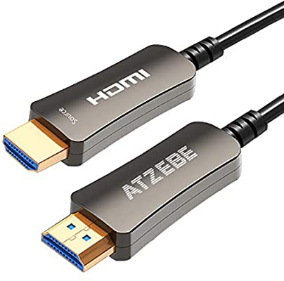

Your post spurred me to search and found a lightening deal on Amazon for these…
50ft shipped one day $31. Shorter was more money. How could I not try it? We’ll see if it will pass I2S but I don’t know why it won’t. The cable meets the spec or it doesn’t, it has no idea what is modulated on it’s conductors.
As far as I know the PS Audio i2s spec is not using the HDMI spec at all, just using the same connectors and cables.
I’d be surprised (and interested to hear) if it does work, but I doubt it.
I would question the RF noise introduction from the optical to electrical conversion in the plug.
Right, but since the IS2 spec uses a standard copper HDMI cable and this optic HDMI cable meets all the same specs for data transmission…ergo me thinks it will work fine.

I tried one last year, would not work from DMP to DSDSr. Works great from computer to monitor. Any ideas?
poorly reviewed on Amazon…maybe falls under the category of “too good to be true”?..maybe the less expensive competition has caught up(?)…

Very well could be too good to be true but the lack of risk…
It arrives tomorrow and if it doesn’t work it will sit on the porch and leave the day after and the funds will be back in my account within hours.

They do have a footnote that reads: * This Optical HDMI Cable is not compatible with A/V
Which I find to be an incredulous claim!
yeah, that doesn’t make sense to me…what other applications are there?
Exactly.
To memorialize the experience, I’m going from a Pink Faun I2S board to DS. Interestingly, this board does not pass the bit perfect test but sounds much nicer than any USB connection I’ve tried.
I also tried an optical HDMI with the DSD and it did not work. Ted Smith said IIRC that there needed to be an electrical connection via the HDMI the optical does not have.
Ah, to sense the input is active probably. Oh well, nothing lost.
