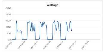

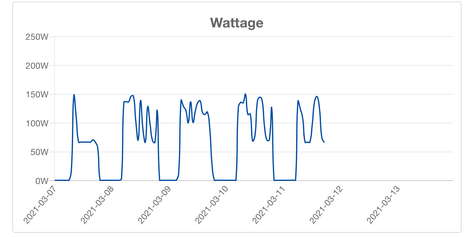

I have P12 with the following gears plug into it
SGCD / M700s / DSDAC / PST / pair of 750W JL Audio D110 subs.
Power usage is under 150w

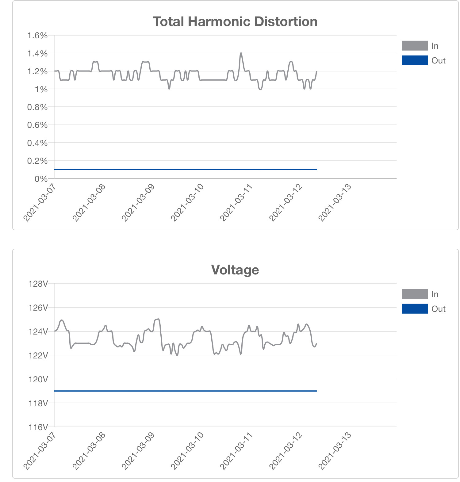

Thank you for this graph. This the real-life information I’m looking for.
I check the spec of your sub, it is class AB. So, power efficiency is about 50%. My sub is class D, which has good power efficiency. So, I guess you subs will draw more power than mine.
When I get my P12 at that time P3 just release, I seriously looked into P3, 300W in P3 vs 1000W in P12, plus, P3’s HC outlet is HC or regen, but all P12 outlets are regen including HC zone. I also use the network feature a lot. Of course, P3 has very good price.
