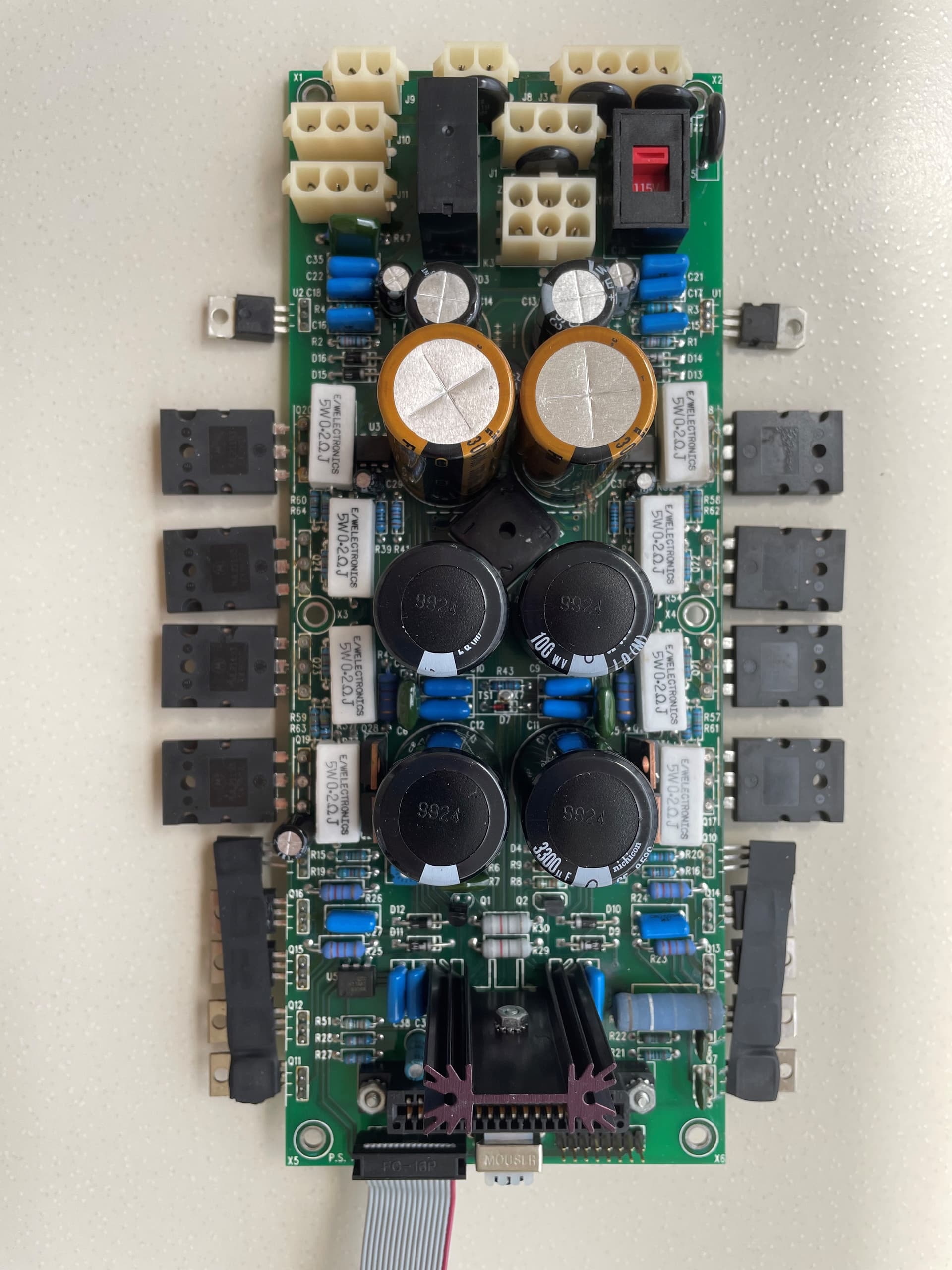

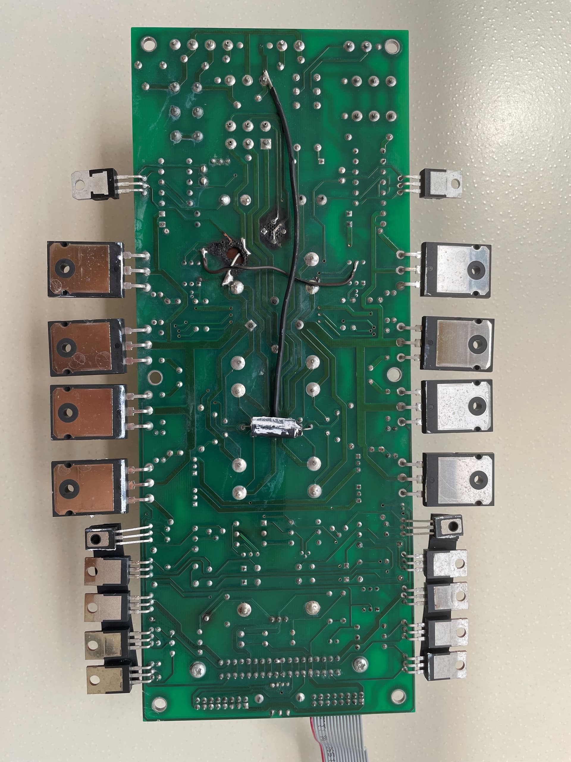

@Citrofix Upon inspection of the bottom of the main board, it seems that my amp had a similar issue as yours.
However, the extent of the damage is significant.
It seems the previous owner attempted to repair by changing a couple of the large caps, the smaller bridge, and a couple of transistors.
When powering it up using a dim bulb tester, it indicates that there is a short somewhere.
I have repaired PCBs in worse shape than this but when it comes to a device I will plug my AV gear into, I am not willing to take chances. Charred portions of the PCB can lead to even greater damage. Damaged vias are also a pain.

Hi. Could it be a short in one of the Darlington transistors?, worth checking with a multimeter. Its pnp on one side and npn on the other, so measure opposite way with multimeter on diode test. Nice video on youtube with “mend it Mark” repairing a P300.
Changed the rectifier bridge with a similar one (from RS Components), works fine again now, did not blow the 5A fuse I put in. Will buy the specified 3A fuse today. Before I repaired it, there was a 15A fuse…
Yes, I checked not only the transistors but also everyting else.
Given the board damage, it may be something else.
Yes, the “mend it Mark” video on the P300 repair is what drove me to buy this one.
Unfortunatey, the damage I found is worse than expected.
