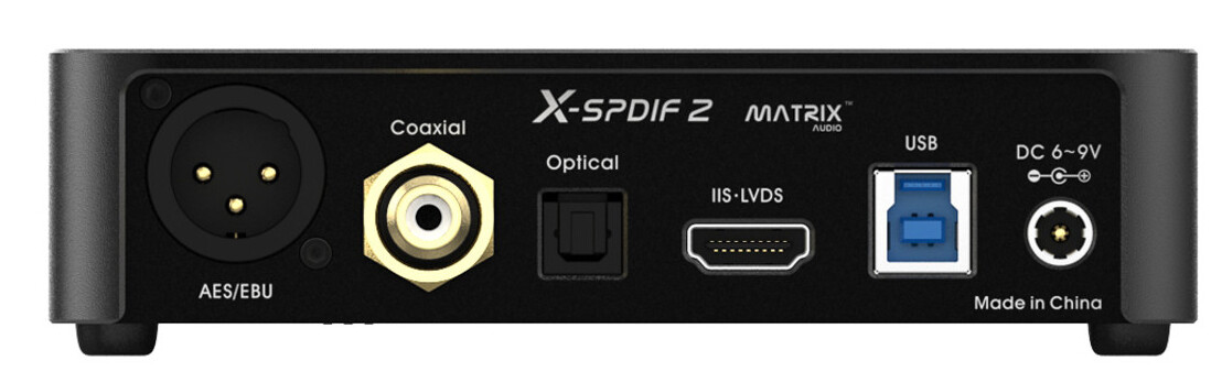

I did a brief look last night for 12S to USB and found one card that claimed it could, but I did not find an off the shelf offering. It was late, so I may have missed something.

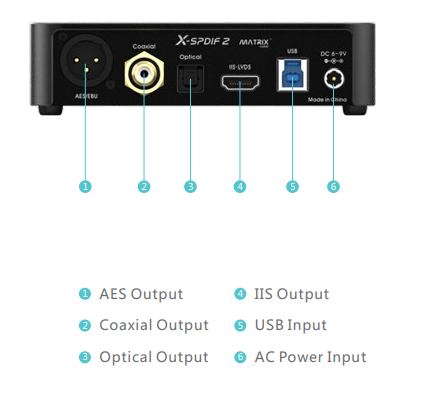

So does that mean the matrix, denefirps, and SU cannot? The back does not label any as input or output. I have to read the manual
EDIT: USB is the only audio input
