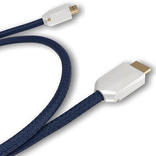

HDMI from Amazon…Highwing? It was made for up to 8K HD.
Might want to consider investing in a better I2S cable with what you have invested in the rest of the system. This one is an easy recommendation for not a lot of money relative to other options. You of course won’t pay VAT so the price will be lower.

Is the PST brand new? If not I would suggest like others, upgrading your HDMI cable.
I purchased used. I have placed an order for a new cord. Hopefully it will help!
If it was the Amazon cable causing the issue then the Ricable will resolve it as neither of the Laiv DACs have shown any hint of brightness to me.

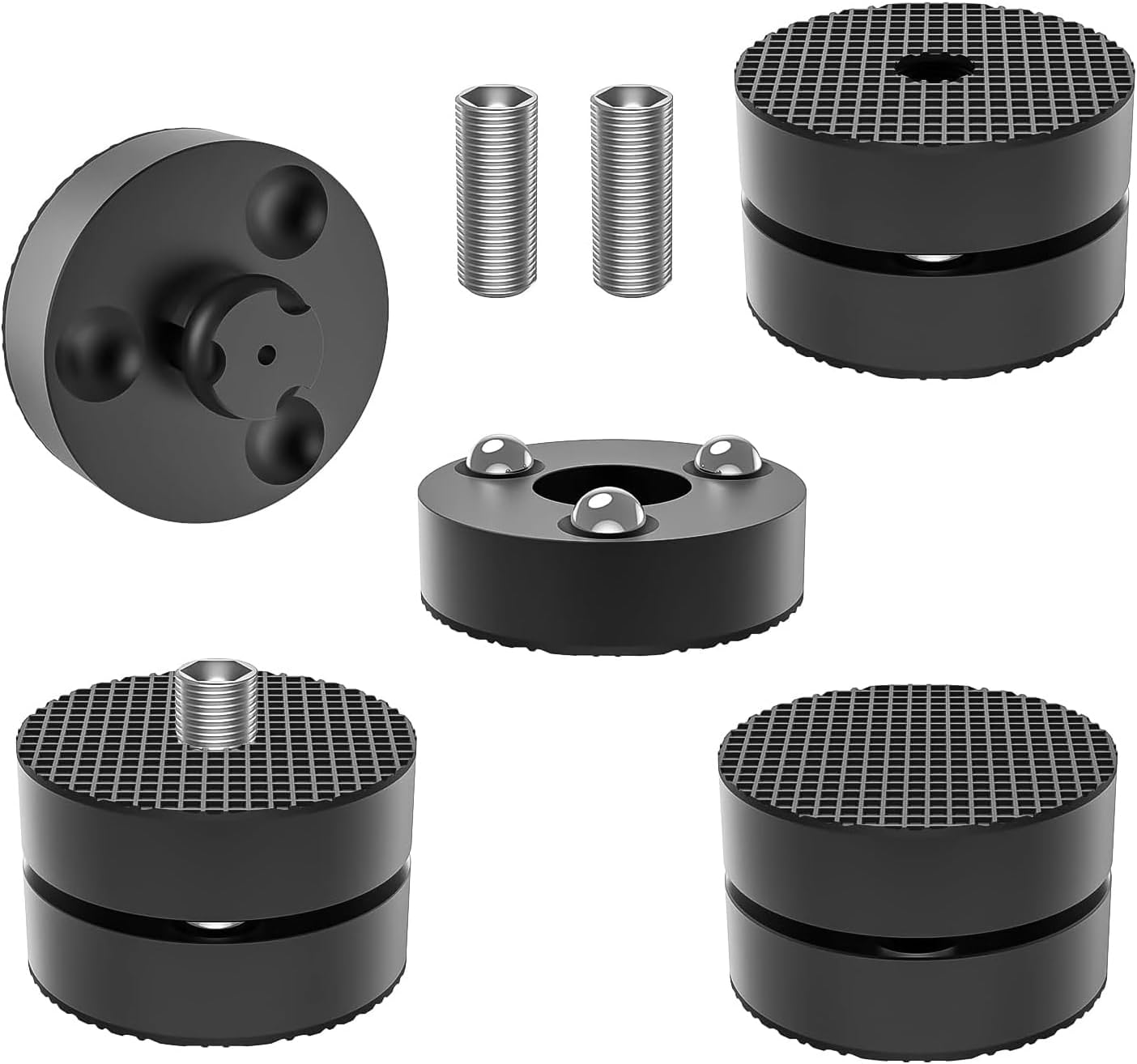

I assume you’ve noticed, but unlike it’s big brother the uDAC runs pretty warm so it needs good ventilation on all sides and it wouldn’t hurt to put some sort of isolation devices under the four feet themselves to get it more air on the bottom. These do the job quite well for little money. The point of the feet on the uDAC actually rest in the hole on the top of the footer.
