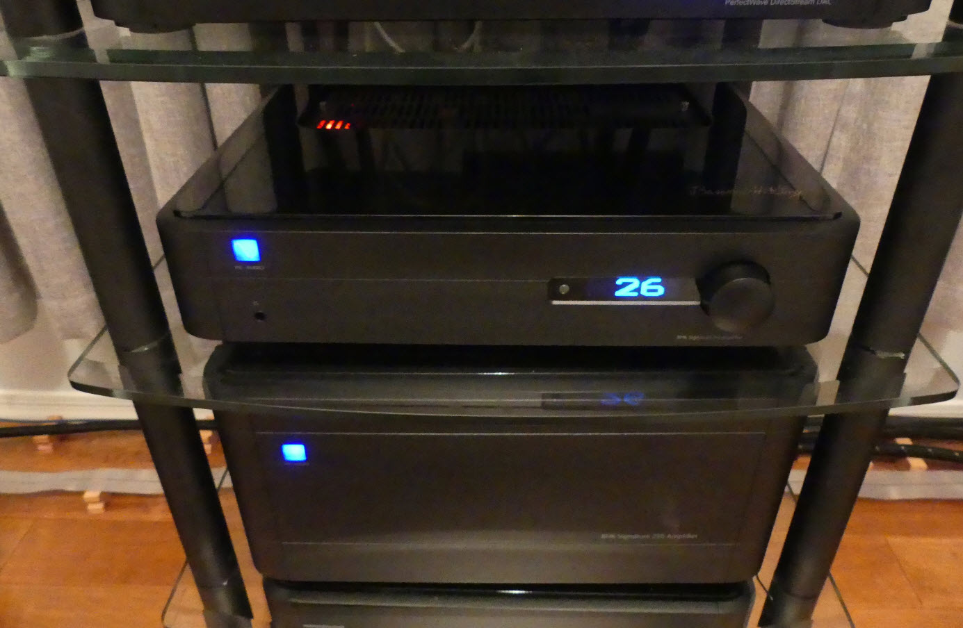

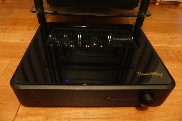

BHK “select” tube w/ Rx-9 dampeners for BHK Preamp -
I just changed the PSA BHK Preamp stock tubes for the BHK “select” tubes. I modeled the shelf space with VISIO before I ordered the Herbies Fat Dots (0.250in). They’re exactly as specified; wanted to maintain 0.25in space on top & bottom of preamp for airflow and also isolation from shelf & PSA DS DAC. Didn’t like the (4) large felt dots on the bottom of the PSA DS DAC (stock) for airflow if I stacked the units so I decided to get rid of the 3/8in feet and replace them with 0.250in Fat Dots (0.25in) and they stacked as planned.
The down side is I have to wait for my Nordost Valhalla 2 XLR cables (drop shipped) to listen to my new BHK Preamp. I have a set going from the PSA DS DAC to BHK250 amplifier; love them! Oh well, looks like I will have to listen to the new tubes in the BHK250 amplifier.
So after setting up the PSA DS DAC on top of the PSA BHK Preamp with just 0.250in on top of the BHK Preamp, I turned it on for 4hrs (thermal soak) to see how the BHK Preamp was heating up the PSA DS DAC. Come to find out it was getting pretty toasty… :slight_smile: I reconfigured the rack to allow the BHK Preamp room to breath and not all over the bottom of the PSA DS DAC.
Also, love the BHK Preamp tube “ON” time counter - down side is that I can’t use it for the BHK250 AMP because there will be times I just listen to the head phones and my AMP will not be turned on. I guess I will have to get a sense of the speaker/headphone listening ratio…
Much Better Configuration -
Glad to see you changed your layout. When I saw the shot with the DAC on top of the preamp I immediately thought that would have a negative effect on the lifespan of the preamp. it has allot of vents in the top for a reason.
@sixpack1 - Yeah, wishful thinking. Being an engineer, I measured the 1m AC-12 power cords already; have to have a back up plan. That was the first thing Brett commented on 4 hrs ago in a private IM… “have you lost your thermal mind”, in a nice Brett sort of way… :slight_smile:
Bonus - rolling tubes is really easy in this configuration.
Also, as an aside, the new BHK “select” tubes sound better right away. Not amazing, just a little warmer, better background. They need to be broken in…
Yeah, just after 30min in the new configuration both Preamp & DAC cooled down quite a bite. They are now quite cool to the touch. Experiment confirmed not to place a component on top of Preamp without sufficient space. 0.250in is certainly not the distance…:+1:
Those glass shelves can support all that weight? The P-20 and the BHK-250 are both extremely heavy. I would hate to hear a loud crash in the middle of the night and for you to come down and find the P-20 on the floor with the 250 on top of it!
@sixpack1 - I believe they will hold over 200lbs each and are quite thick. The rack has been in operation since May, 2018 with zero fatigue. You would be surprised how thick the glass is…
