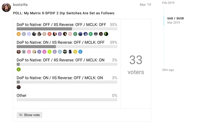

I decided to try out a Matrix Audio X-SPDIF 2 USB Interface, to compare to the Ultra Digital.
It’s a close race, but does anyone know where switch 3 is supposed to be set to use with the Direct Stream DAC? The manual and e mails to the company aren’t much help.
Has something to do with the master clock I think. Both positions sound good, but different.
