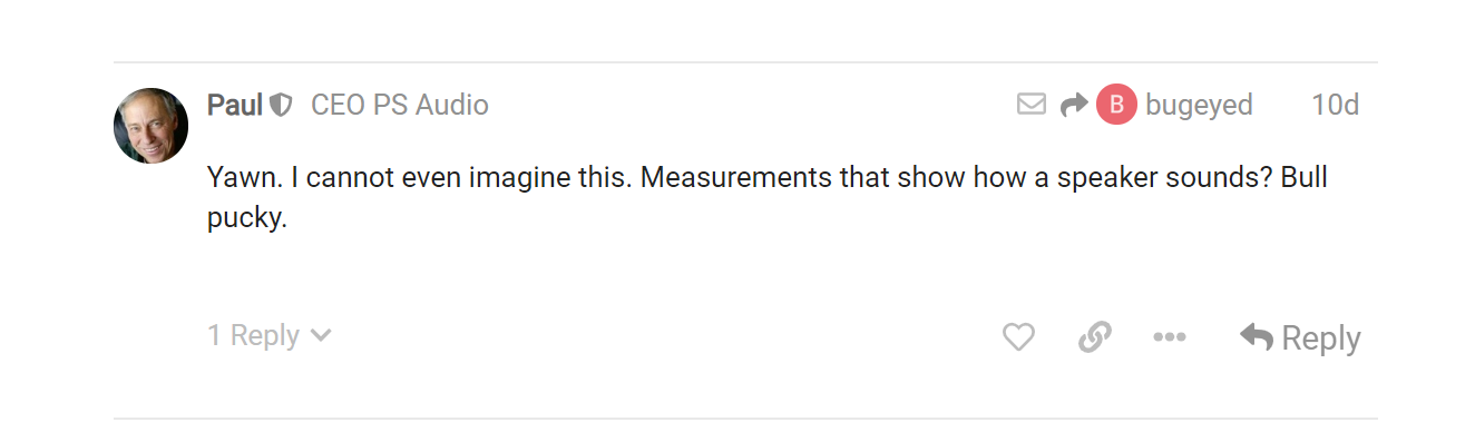

I am surprised you are entertaining the use of measurements for any validation. To quote Paul directly:

I don’t need convincing, I simply assumed that Paul’s comments reflected the PS Audio speaker design philosophy when he called speaker measurements ‘bull pucky’.
In this case I would disagree with Paul. And I’m betting Chris does as well. You don’t manufacture ANYTHING without measurements. Unless you’re selling snake oil that is - then it really doesn’t matter.
Number three for me please.
If you look at the context of Paul’s quote, it says nothing about measurements. It says that you can’t tell how a speaker will sound based on measurements. I agree.
