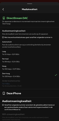

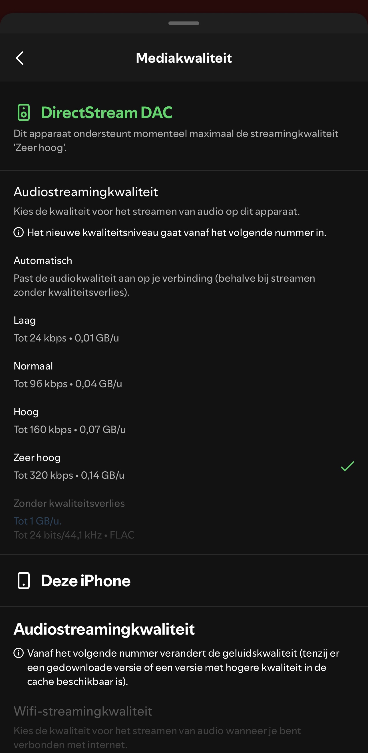

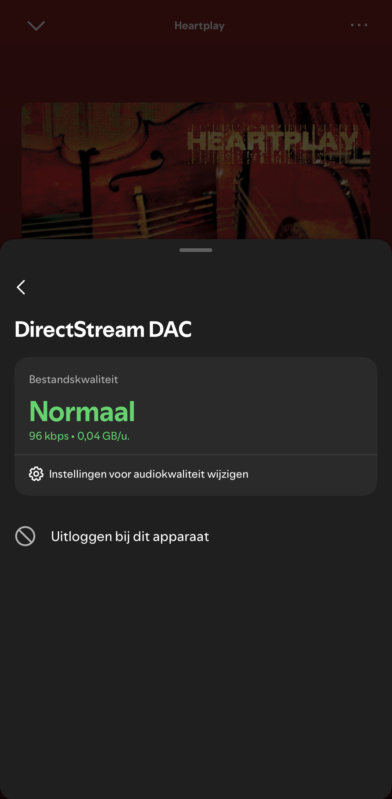

Spotify has recently introduced their lossless service, but I’m not sure if it’s already available in every country or fully supported on all devices. I can use it on my phone and on the desktop app, but so far I haven’t had any success getting it to work with the Bridge II. When I check the streaming bitrate through the Bridge in the Spotify app, it actually reports only 96 kbps, even though I set it to 320 kbps.
The setting for lossless is greyed out and unselectable:
Has anyone here managed to stream Spotify Lossless into the DirectStream DAC Mk1 (via the Bridge II)? Or is lossless support simply not possible at this point?
