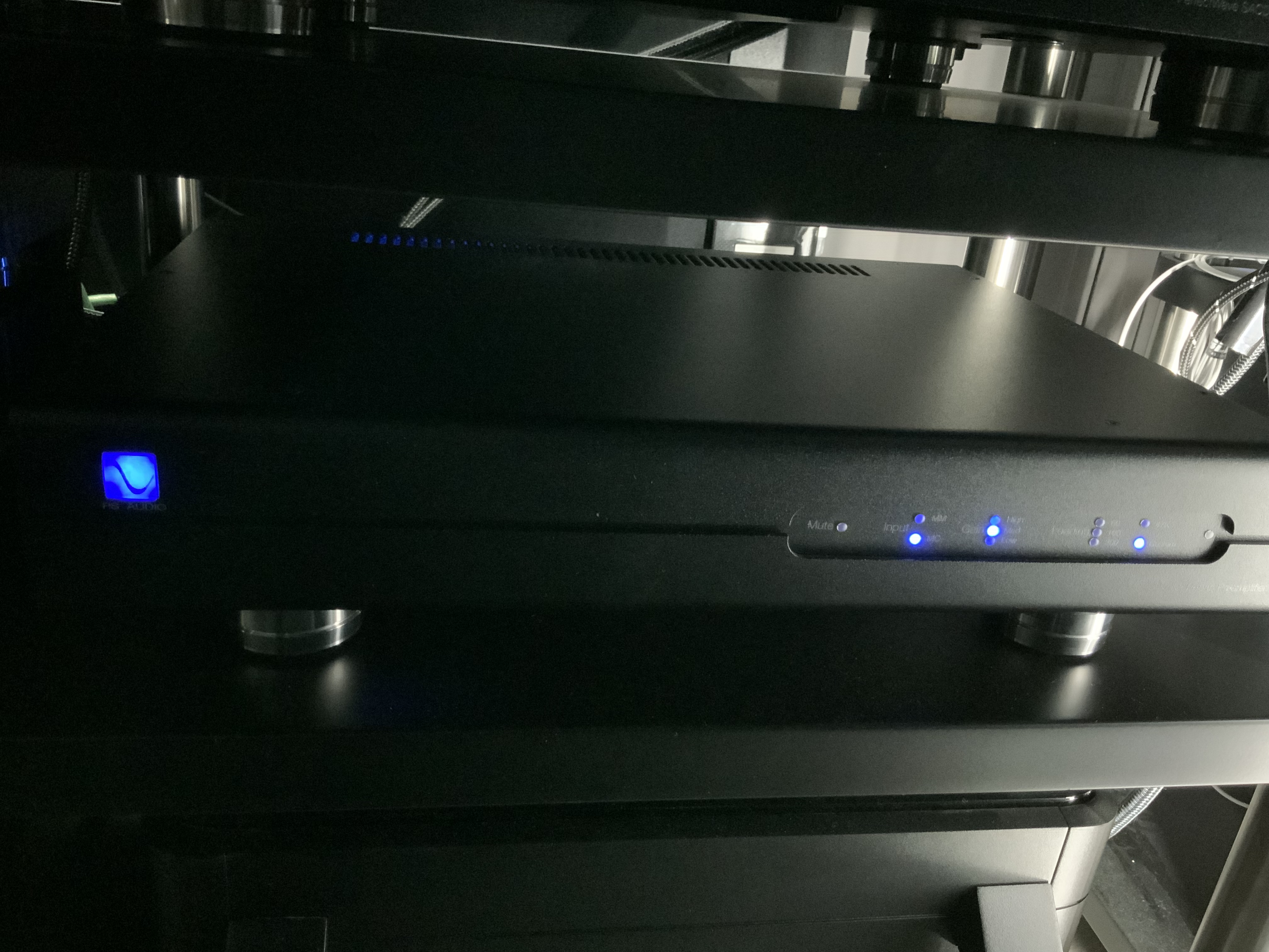

It seems that during last days my gear issues are never ending.
Now the Stellar Phono, too!
After a few weeks, today I decided to listen to some vinyl. Suddenly I encountered another issue with my big surprise. No sound when the cartridge is surfing on the record. What?
  • if I listen very close to the cartridge, I can hear music correctly (from mechanical contact, I mean)
  • checked all the settings on SPP like MC, no Mute enabled. gain, loading
  • checked cable connection from TT to RCA input MC of the Phono and I tried 2 different cables to be sure
  • checked cable connection from XLR SPP output to XLR BHK Pre input, in different inputs and trying 2 different cables
  • tried a few power cycles of the SPP
Is the TT or the phono I was wondering. Then I called my dealer and he suggested to try to connect the RCA cable directly from the TT to the BHK bypassing the SPP. If at a higher level you are able to hear the music from the speakers, it means that the signal from the TT is ok, excluding a cause… he said.
Guess what? I can hear the music. The signal from the TT out is ok.
So the culprit seems to be the Stellar Phono. It’s like having the Mute enabled, even if it’s not enabled.
Any idea?
Thanks.

Sometimes my Stellar Phono defaults back to MM when I think I’m still set for MC thus muting the sound.
Unfortunately the setting I checked more and more times is correct, MC, with the blue led open. At first sight I was thinking the same, or the Mute enabled as sometimes happens when you don’t pay attention to it. Or you switch it on. Not in this case, sobh!

Have you tried running the cartridge into the MM input? I would also try all of the gain and loading settings. Finally have you tried both outputs?
Have you used it since the masterful renovation of your listening room?
I tried MM/MC, all the gain levels, all the loading values, included custom with the two little knobs on the rear panel.
I tried unplugging the PC for an hour.
I tried unplugging the input RCA cables, and using different pair.
I tried also different XLRs cables from the output.
I tried disabling the Mute function both with the remote and long pressing the front logo button.
If I bypass the SPP, plugging the RCAs from the TT to the BHK Pre, I hear the music from speakers, it means that the signal from the TT is working.
