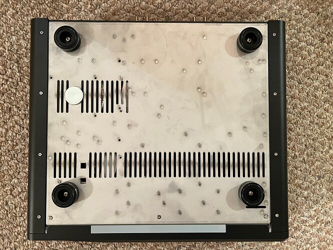

The bottom metal Plate of the new PMG Signature Preamp looks dirty
I took delivery of the brand new PMG Signature preamp last week. The bottom metal plate looks used or old. Is this normal? New owners please check and let me know. This is not a deal breaker, but I never had new audio components with such dirty looking bottom. Attached is a photo of it. There are whole bunch of holes not used. I guess PS Audio came up with a universal bottom plate that fits all the new PMG components?
That doesn’t look right! Not on view but not a finish that I’d expect.

Yes, that is normal. Sorry. We stressed over this for quite some time but, in the end, figured that because t’s never actually visible it wouldn’t be a big deal. The metal process used to protect this plate from the elements isn’t the prettiest. It’s a kind of galvanizing process (of which I cannot remember the name). If you look at the plate in detail, notice all the marks which are the underside of PEMs-they are press in fasteners-and there are dozens of them. The punching and insertion process is pretty intensive and then the plate has to be refinished with that galvanizing process so it is conductive (for the ground plane) while at the same time protected from the elements. In any case, all that to say we couldn’t paint it because of its role in EMI so it looks kind of ugly. Thankfully it’s on the bottom.

Yes. One of the ways we were able to keep costs and, hence, retail prices at bay (with an inch and a half thick front panel and all) is to make things like top covers, bottom covers, and front panels universal. That way we could take advantage of higher quantity pricing from the machine shops. So yes, all PMGs share many common parts including bottom plates.

Not sure if this is one of those penny pinching decisions, I don’t remember the last time I see this ā€œdirtyā€ bottom plare from any manufacturers at any price. A bit disappointed to see this from PSA, especially the founder series and especially at $8k price.
