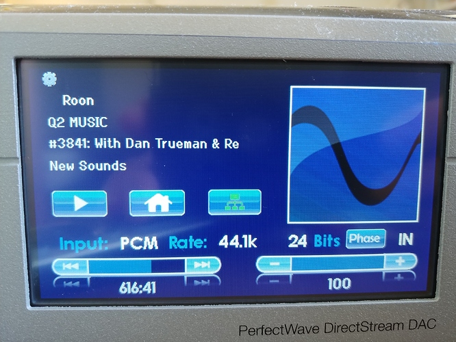

this shows the attenuator is off and i am at max vol 100.
Just to double check, are you on a recent release (Huron or Redcloud)? There are two maximum volume settings, one for use when the attenuator isn’t used (High) and one for when it is used (Low). You need to change from using the attenuator to not (or the other way around) to get to each. Please see if you can use the remote or explicitly tap on the + or - on the screen to exceed 100. I’ve never used the bridge, but there’s a chance that your control software is overriding your volume settings so check with some other input selected to make sure.
hi ted

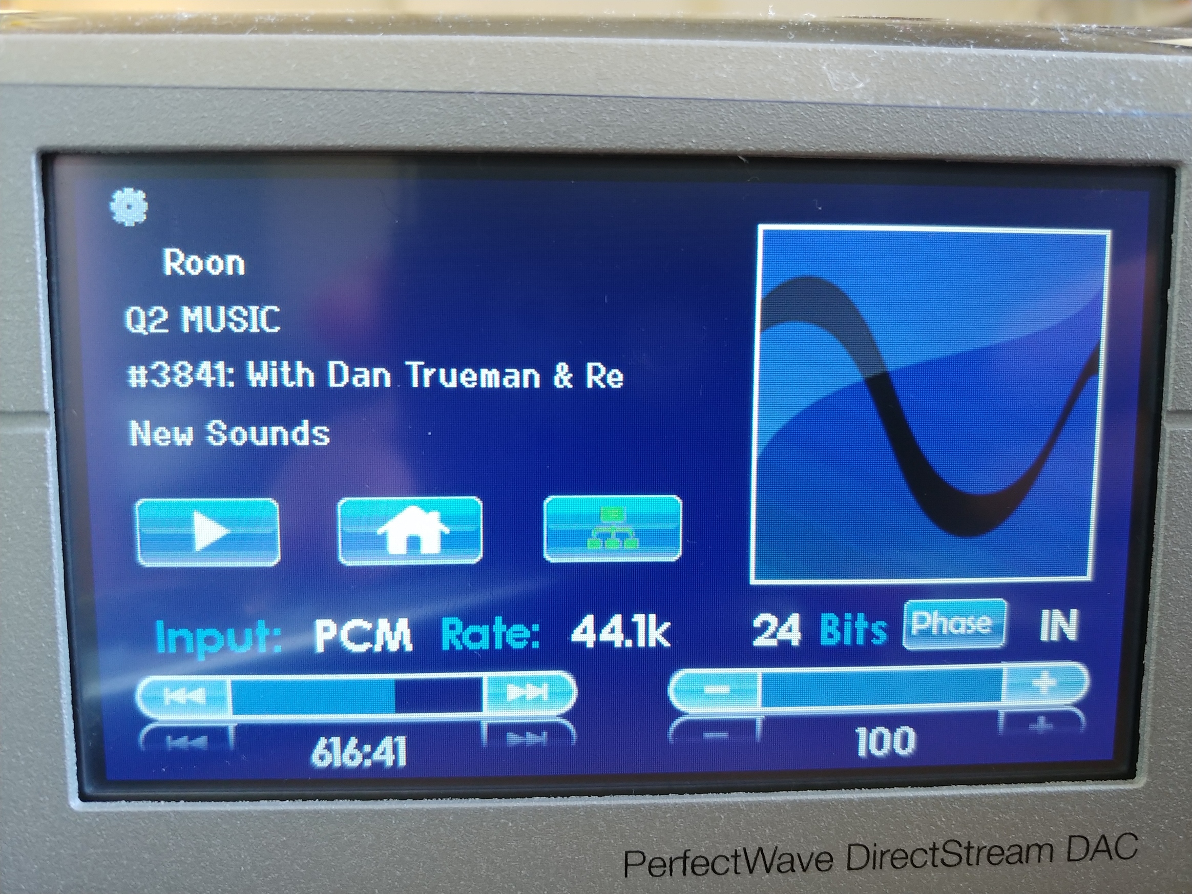

i am on redcloud, whether the attenuator is in use or not i am unable to go past 100. i checked usb as you suggested and i am maxed out at 100 on usb as well. attaching photo. !
The photo I posted was using the Bridge II card for input.
