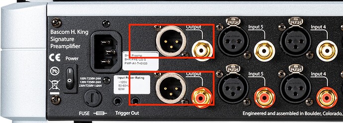

@Paul could someone confirm the distance that the RCA output connectors protrude from the back of the BHK Preamp chassis? See below a) an engineering diagram below from Purist Audio Designs of their XLR splitter (which specifies a required clearance of 18.75 mm), and b) a mockup of the back of the BHK with the approximate positions of the two splitters.
I would try to measure, but my BHK is in for service. (and sorely missed)

I am hoping the Purist Audio Design top-of-the-line XLR Splitter (which has an engineered aluminum housing, inside of which is their premium cable with an air dialectric) will be compatible. The potential problem is the aluminum housing, which in the splitter’s horizontal iteration protrudes sideways from the XLR plug and would cover (but hopefully clear) the BHK’s RCA output. See diagram below. PLEASE NOTE the engineering diagram shows the VERTICAL orientation. The HORIZONTAL orientation rotates the XLR female connector 90 degrees – necessary since the BHK’s outputs are stacked vertically.

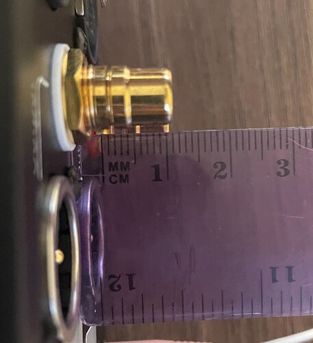

@ chris_y Sure, I’ve gotcha. Give me just a little bit.
So, I think you’ll be good. I measure about 12-13mm from chassis to RCA’s farthest point on on the BHK Pre.
