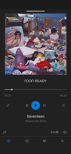

I generally do not use the native app control of our dCS Rossini, but if you look in the lower right you’ll see db for volume control.
Pressing the volume icon brings up this control wheel.
