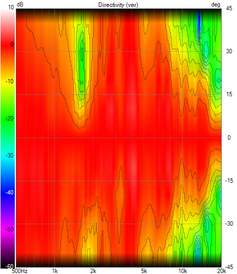

I recall reading somewhere on the forum that the horizontal dispersion of the Aspens is reasonably wide, but not so much in the vertical plane. Is my memory correct? If so, would that be an issue given that my listening chair is higher than average by three or four inches? Also, given my room layout, I sit a little closer than is probably ideal. (I’m leaning towards an FR 10 but still might push the budget for a 20.)
I recall this same thing. There was a discussion about tilting the speakers being more crucial than toe in or out. Also that any change in height of listening position had an effect. I can verify this from personal experience. I recline a bit sometimes while listening (not lazy boy style) and a few inches in height does impact the sound, although not dramatically, just noticably.

FR10’s have reasonable vertical coverage (even though the midrange is tall) because of the low crossover point used. Still, there is a dip centered around 25 degrees above the speaker at the crossover (1.75 kHz) and the tweeter gets beamy vertically, especially above 15 Khz.
Still, you have +/- 5 degrees or so and that will more than cover the few inches difference that you’re talking about without issue.
Below is a vertical polar map with the contour lines set at 3 dB.
Kudos for doing this, Chris. I honestly can’t think of an uber priced speaker company that would volunteer to post technical information like this. They may be out there, but if they are I just haven’t seen any evidence of stuff like this.

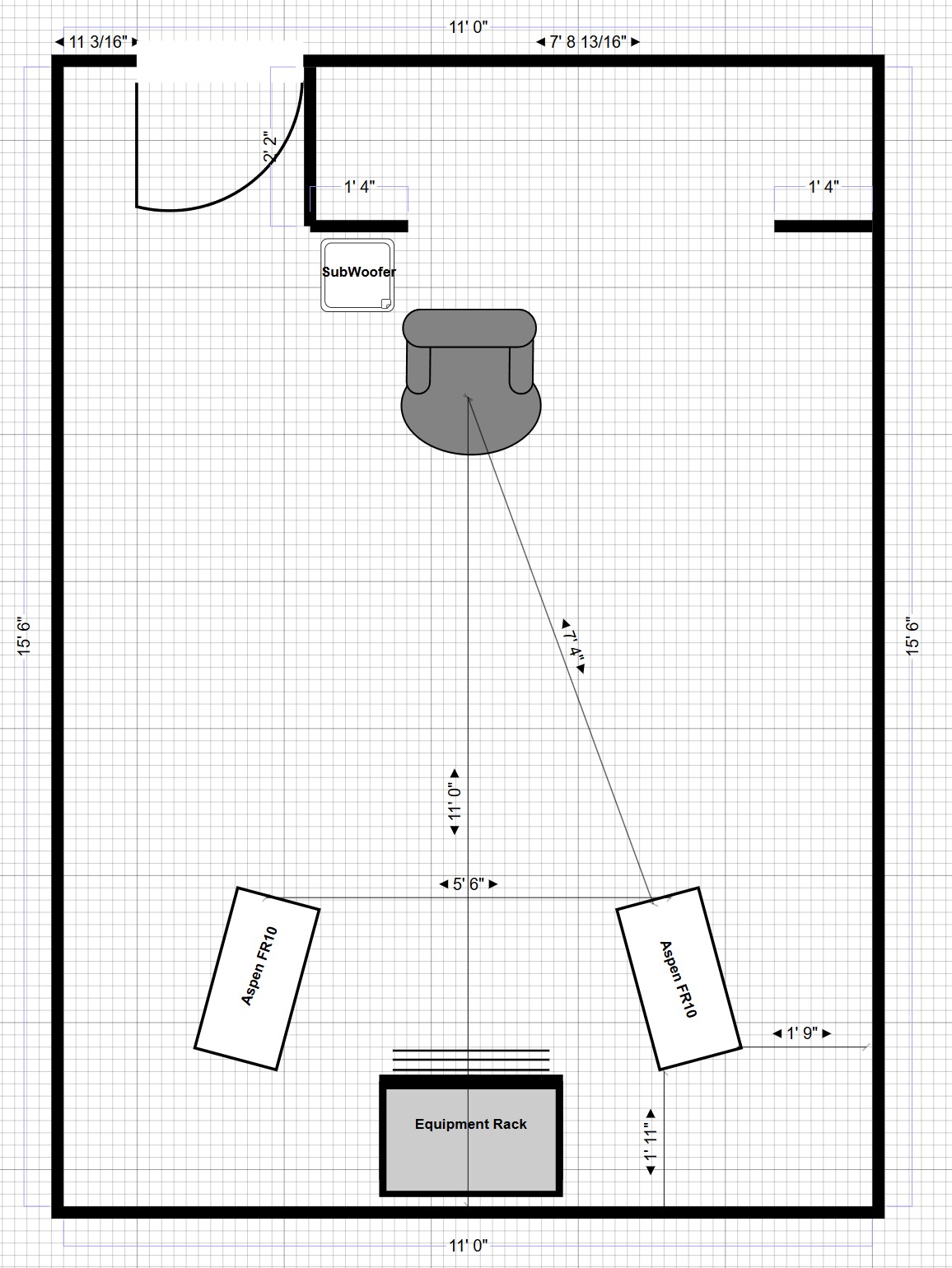

Ok, I’ve measured my room setup/placement and tried to represent it somewhat accurately. Scale may be a bit off but the dimension labels are fairly accurate. The sub placement behind the listening position really helped tame the base boom in the room. I had turned off my sub while I adjusted the FR10’s position as I wanted to focus on getting the highs and mids sounding their best.
Room treatment includes absorption installed over the large window behind the rack and some homemade diffusers on side walls etc. Nothing expensive. I am open to comments and suggestions/questions.
That’s impressive! You must be an engineer. One question. I thought I remember a post of yours where you mentioned no toe in but the schematic shows toe in. If you have toe in what did you settle on ?
my set up is an equilateral triangle but the right speaker’s wall is at a diagonal and flared out because there is a gas fireplace over there. That had caused a placement challenge for me
It’s not really to scale - just used a Smart Draw program. Yes, at first I did try no toe in, but I eventually increased the toe in until I found the spot. I do not know how I’d measure the toe in, but it is not quite as drastic as the schematic shows.
Sounds like you have a challenge but a flare out is better than a flare in. There are folks here who have dealt with all sorts of strange room configurations. I am rooting for you to find that magic adjustment. You’ll know when you get it right.
Thanks. I got stop moving them around so much but the clock is ticking fast on the 30 day trial. On top of that I’m dealing with a disc herniation so I have them on furniture sliders for now
So far for me 3 feet from the side wall is actually worse than a hair over 2 feet
I have them toed in so one edge is 2 inches more than the other edge from the front wall
I remember Chris saying that 18 inches from front wall and the same for side wall is usually enough and that more may not be better. I had mine on sliders too. Those things were surprisingly heavy for being the little brother of the FR20s! You might be able to talk to sales at PS Audio and get a little extra audition time. Might be worth a try.
This would be my setup, moving the speakers a little further apart and sitting a little closer to the speakers and allowing more distance between you and the wall behind your ears.
