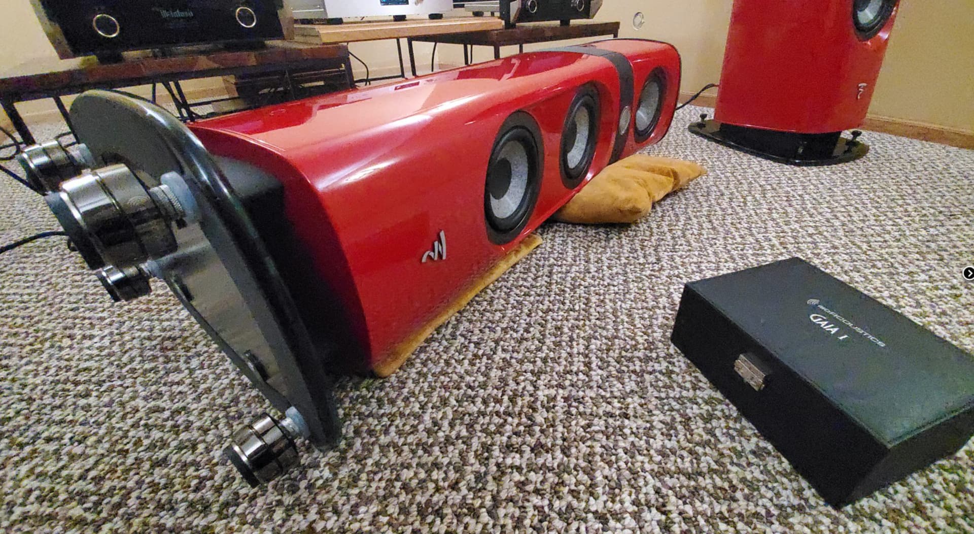

GOOD NEWS to all !
@ Stevelj244 …Adopted your advice.
Decided to add Gaia1 To my Focal Sopra 3.
Good news : NO NEED to touch / remove the Speaker’s Glass base.
The sleeve with internal screwing that’s hold the original spikes can EASELY REMOVED ( Fell down on the floor without touching )
So the spike now can be remove without touching / removing the Speaker’s Glass base at all !
Please see pic.
