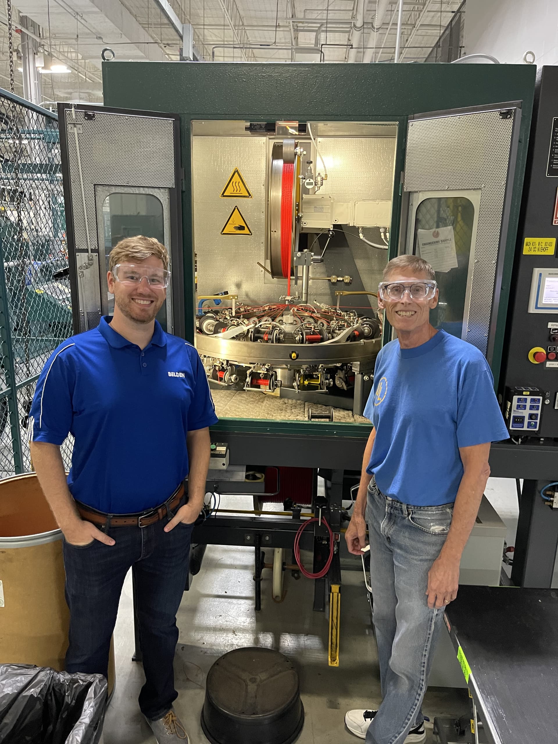

Galen’s EE at Purdue and decades working in the lab and manufacturing facilities at Belden provided what in my opinion are unique and simply unmatchable advantages of any and all other cable design engineers. Within any given specialized scientific field there are numbers of participants that earn their degree and many spend years within their profession and speciality. A few rise to an obvious top and are considered the best in that field. I’ve seen Galen in a room and around a table with a pile of EE’s that are simply amazed at his understanding.
I’ve seen Galen flown to various Belden manufacturing facilities around the world because the process and manufacturing engineers would claim that what Galen was asking for could not be programed or the machines made capable of the process only to have them totally humbled when he left with the machines running. Fighting with Galen about this field would be foolish and futile. I don’t know if Galen knows or admits his IQ but I bet it is off the charts. I don’t want this note to go to his head because there are things he doesn’t know. We clash on occasion. I don’t often win.
