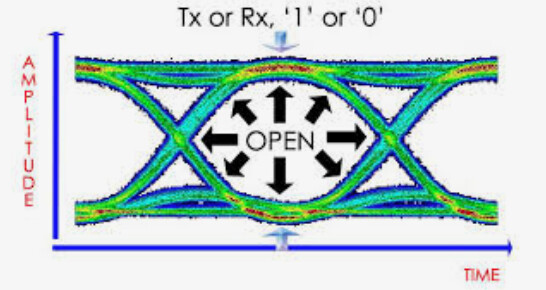

And at RF impedance is SQRT (L/C) so no reactance…it is just “R”. We terminate into a pure resistor. This is why digital works as well as it does. We mostly have attenuation. An Eye patter is distorted in the time base by ISI, not resistive amplitude base, and Inter-Symbol Interference (ISI) that “closes” the eye. Very carefully circuit transmitter and receiver design attacks ISI.

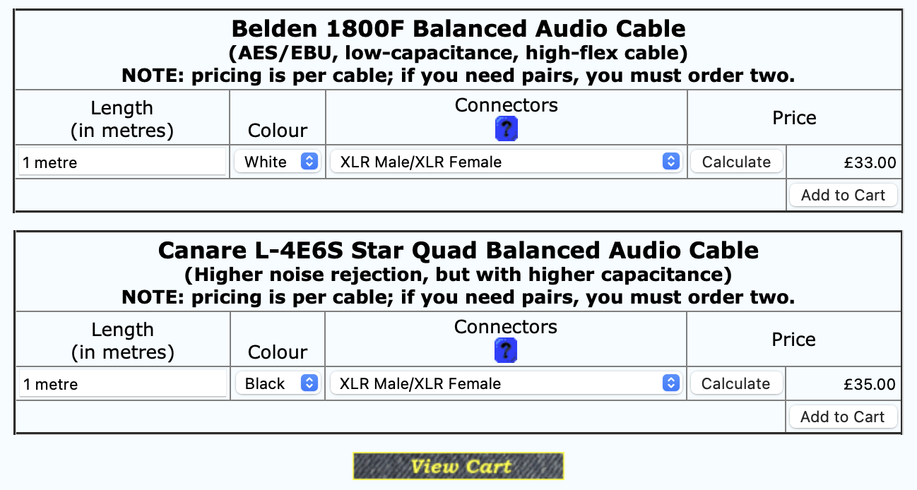

Blue Jeans Cables offer these - are they a related business? The website looks similar.
They use a different connector. The ones I bought use the cables used by Iconoclast.
They say:
As an alternative to Belden 1800F, we now offer the popular Canare L-4E6S “star quad” balanced audio cable. This cable uses two pairs of conductors in a quad configuration for better common mode noise rejection, surrounded by a full tinned copper braid. The capacitance of the star quad design is higher than for a single-pair cable, but its noise rejection characteristics are excellent. For most applications, we recommend the 1800F, but if you are dealing with induced noise problems, the star quad cable may be a better choice.
I wonder what “induced noise problems” are.
Blue Jeans Cable assembles and sells Iconoclast cables. Further details are best provided by BJC reps.
Regarding induced noise problems, wire in addition to providing signal between components also acts as an antenna picking up stray electromagnetic emissions. For example electromagnetic fields from adjacent power cables, especially if they are parallel to the signal cable. Same goes for RF frequencies from servers, routers, digital clocks, etc. Several means to reject these emissions are provided for by shielding and/or a balanced interconnection. Star-Quad connection also provides a means to reject external noise. Longer interconnect runs are more susceptible to picking up induced noise. Long runs is where implementing balanced cable or star-quad cable excels in comparison to single ended cable.

Thank you @weedeewop , that’s enormously helpful. Seems like I chose the right cables.
BJC stated L4E6S is higher capacitance. I looked it up and it was double that of Belden 1800F. What I did not know - is it important?
Your article stated:
“A high-capacitance cable can result in a greater high frequency loss in long cable runs (such as 60-80 feet or longer).”
Well, my cable runs are 3 feet and at 59 I can’t hear anything close to the 15khz it referred to later on. So, very simply, the higher capacitance referred to by BJC seems an irrelevance.
In other respects, the Canare L4E6S does a lot of good things, like eliminating noise very effectively.
At those capacitance values per foot at three feet the difference between the two is irrelevant. Your ears may say otherwise, comparing in your system is best. Also, for a three foot run star-quad balanced is not likely needed unless you are dealing with noticeable magnetic interference.
Star Quad gives the cable Vp alignment variables not available with two conductor XLR designs. It isn’t just capacitance alone.
This is why the series I and series II XLR use star quad, to improve the Vp properties and still provide low loop DCR for long runs. The series II has even better Vp alignment and lower DCR but with a more complex design.
And yes, the damage cables do is also definitely by the foot! Shorter is better to an extent. There is a length, 1 meter or so, that shorter isn’t an appreciable advantage.
