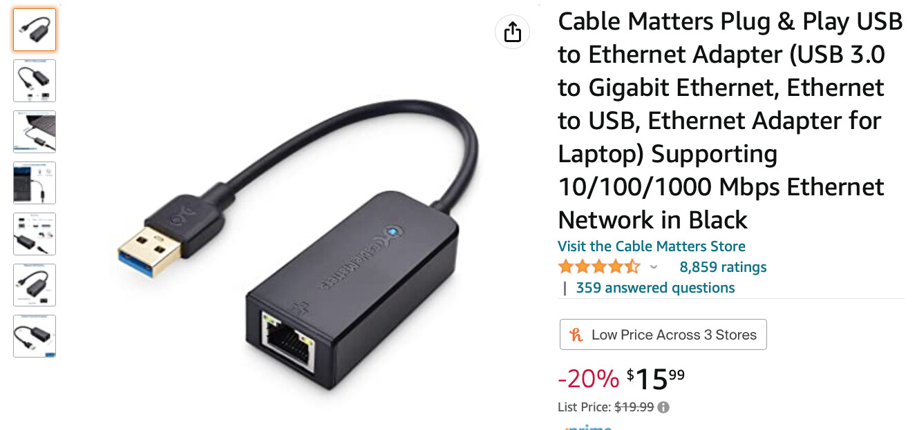

dvkennedy61, moving the computer or DAC is not really possible. I did find these items today which would seem to allow me to utilize the ethernet network and just convert it to USB just before going in to the MK2. Does that sound reasonable?
I think at this point you are going to have to start with one of the devices that have two boxes one at the PC end and one at the DAC end. What you posted above looks like a device to use ethernet over a USB port on a laptop. For instance if a laptop didn’t have an RJ45 and you wanted to hardwire it to your network.

Note: I can imagine a use case for the laptop USB hub… Some sort of media server is running on the PC far far away in a concrete house, and you have an old Microsoft Surface that has only one USB port and no Ethernet jack. Then the hub would allow you to use Ethernet in to the Surface and USB out to the DAC. But that probably won’t be one of the recommended setups in the end! And there will be more than one recommendation from which to choose.

I am pretty sure those will not work for your needs as they are network adaptors not usb extenders.
You need something like this Monoprice USB Extender over CAT5E or CAT6 Connection up to 150ft or this Intelix Full-Speed USB Extender - Transmitter and Receiver Kit
I agree with @2muchgear. You need adaptors or extenders.
