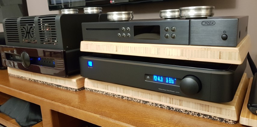

DSJ it’s a keeper!
He has more or less 200hours on it right now.
Somethings are different, nothing is worse (although it seems the bass lost a little body for better control), and many are way better from what I was used to.
But if I had to sum up in just two words: realistic and foot-taping sound. More of the artists interpretation reach us.
No more strange behaviors, or software glitches, after the first week always on.
Setup:
  1. Attenuator out
  2. Volume 95
  3. Coax with external transport (Creek50CD)
  4. USB (curious USB cable) with optimized netbook and LAN (server ASSET UPnP on QNAP)
  5. Bridge II just for tests with TIDAL (for now)
Thanks PS Audio for allow me to be part of this family.
Thanks Ted for such a product and helpful forum activity.
Here it is…
DSJ
Awesome! Looks great and I am so delighted it lives up to its great reputation in your system. That means a lot to us.
