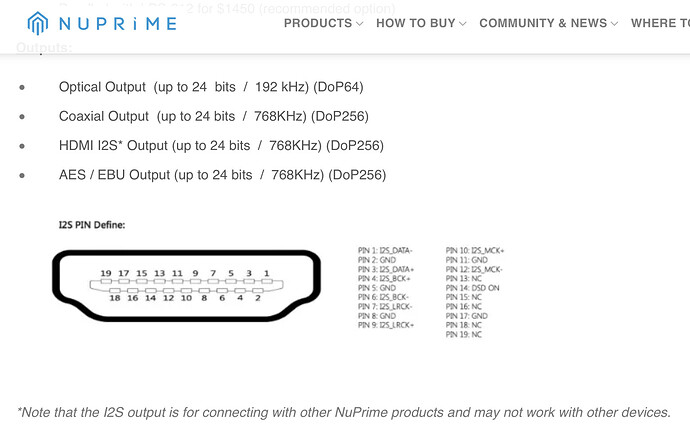

The pinouts I posted clearly show that the pinout for all P.S. Audio products differ significantly from your CDT8 Pro’s pinout. Unless you find a way to change pinout via an adapter of some kind (I haven’t been able to find one), the two units are incompatible via i2s.

I posted YOUR pinout for the CDT8 Pro. It differs substantially from the PSA pinout. To read them is easy. There are 19 pins on each, and each is labeled. So, starting from pin 1 to pin 19 for each pinout you compare your #1 to their #1, your #2 to their #2, etc. all the way through #19. Quite a number of theirs differ from yours. As it stands, unless you somehow change one unit’s pin configuration to match the others, it will not work, Some people may custom make a cable to do this, Otherwise, I see no way of getting one to work with the other.

I’m uncertain that your statement about PS Audio’s never changing the pinout config for the I2S connector aligns with the data in the quick reference guide maintained by Jesus at Sonore found in the post by brett66 (#21? anyway, posted 20 hrs ago).
Columns D and E under the HDMI tab seem to show diff’t pin configs for my PWD mkII vs the DS Sr./Jr./Stellar. . . .
I don’t know the inner workings of how slight differences in pinout can impact whether or not it will work. But if it says it follows PS spec then it will work. You’ll see that NPC also differs from the DSD however that connection works flawlessly. Both with the DSD and the PWD.
