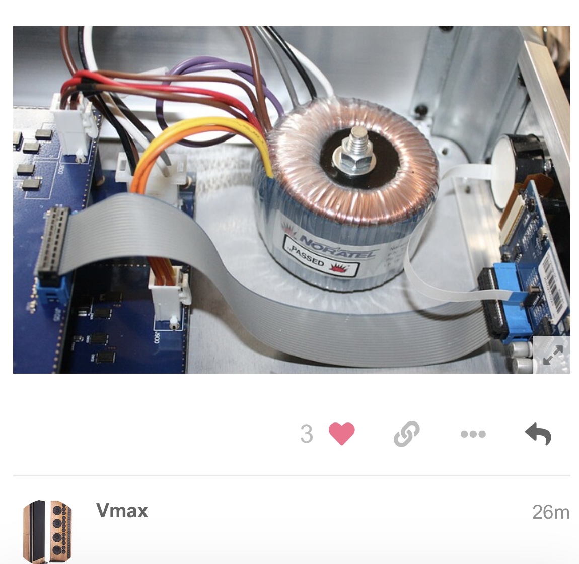

? The analog output transformers are on the opposite side of the box from the display. The display is close to the power transformer. Don’t get me wrong, dampening EMI from the display is a good thing.
Thanks for clarifying. I had hard telling what that power transformer was from photos previously in this thread, but it did seem large for an 4400. I was expecting a toroidal. Yes that means display emissions could be affecting many of its different voltage outputs inputting noise into recipient DC circuits.
If we can quiet the display with absorber it is a sizable noise floor drop just from lid placement.
The AC transformer is toroidal. It’s a tall toroid:
I got myself turned around looking under digital board at the analog board in the other mk2 picture thread. Thanks for clarifying.
These photos will help with my 3M absorber trials.
@dchang05 I will cut a rectangular piece that covers back half the toroidal transformer where the wires come in. Set diagonally Along with a display piece scalloped not to interfere with side of power transformer

This afternoon I will try different layout based on your observation and Ted’s pictures. My original placement does not look like the optimal one. Thanks!
I am going to also put a rectangular piece on exterior lid running the length of the ribbon cable from front display where it plugs into the digital board it is also transferring display noise direct to orange and yellow power wires to the analog board from transformer by touching them. . I don’t like the other thinner ribbon cable going to the display selector wheel the way it is touching the power transformer windings either. It is possibly inducing noise directly in the windings laying on top of them it is also really close to the other cable.
When I have time to go internal for mods the ribbon cables will get absorber square’s adhered an pulled as far as possible from transformer.

I may try a ribbon cable square of absorber on the MKII floor awhere it touches. It i better to absorb the noise early

I measured from the edge of face plate to the middle of screw, and it is about 3.5". I made some adjustments to the absorbent sheet placement. The square is three-by-three, and the two small ones are two-by-one. The five inches of two pieces starts from left of the screen to the right edge of controls. the three-by-three covers up to 1/2 depth of the transformer, but not the power cables on right. This layout removed the slight mid-bass murk and kept the fullness and soundstage. I like it better than last night and I will keep this one for the time being.
I made another change, and it brought more magic back without adding murky mid-range. I replaced the 2x1 in the back with 3/4 x 3.5 (because I have one), so it extends more towards the back. This is to cover more of the flat cable from the display.
Okay, I hit the sweet spot in my system. I will leave it alone for real this time. :face_with_hand_over_mouth:
Hopefully I have enough material to try this before I order more. If I can just lose the midrange murky from the fir’s attempt i will be happy.
When I covered too much transformer the murkiness showed up. The coverage of the transformer will be the key. Interestingly, when i extend too much of absorbent on the flat cable the sound becomes thinner. So, you can play with these two parameters and find the balance for your liking.
