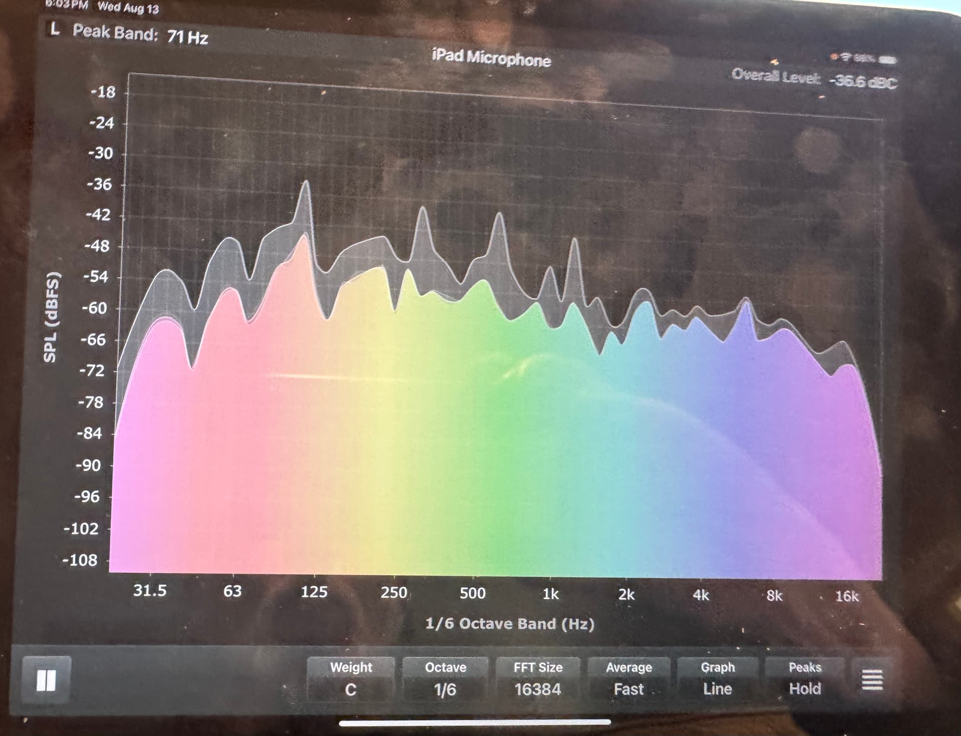

@tony22 Stereo pink noise (from the Nordost System Tuning CD) at the listening position using Octave RTA on an iPad. I don’t have a calibrated microphone that works with this new iPad, but close enough for me…
Sounds great. Q4?
Very nice! Without DSP that’s pretty darn good.
@tony22 I set up the four subs by ear, but that was interesting to see–kinda like using RTI to check my work…
You’ve got a good ear :slightly_smiling_face: , although personally I try to shoot for something that follows a bit more of the Harmon profile.

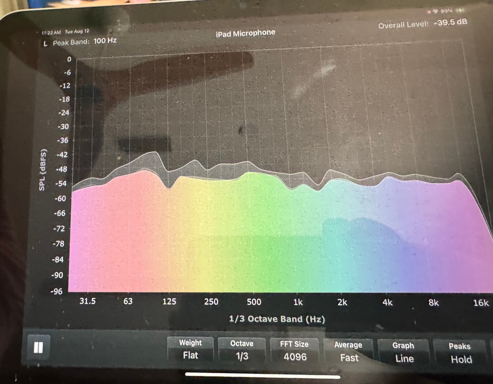

I could probably do something like the Harmon profile without DSP because I have both adjustable subs as well as Fyne SuperTrax supertweeters, but I am lucky enough to be able to play my music at pretty high levels even in the evenings as a result of having good windows and even better neighbors!
Well, keep in mind that with a 4096 point FFT, you only have ~10 Hz resolution and so 10 data points from 10 and 100 Hz.
Each octave is a doubling of frequency and so you only have 4 data points between 40-80 Hz then you are smoothing 1/3 octave on top of that.
In short, you aren’t going to see any of the more narrow band peaks and dips and this potentially makes things look far smoother than it actually is.
You are of course correct. I just did it quicly to answer the question. I’ll change settings and re-run. Or maybe I’ll just let sleeping dogs lie!
FWIW, a faster and finer take. Still showing the peak around 100 Hz, and a roll off at both ends of the spectrum.
Sounds good to me!
Well, I wouldn’t necessarily trust the mic above 10 kHz. It should be pretty accurate in the subwoofer range though.
You might also turn off the sub and measure that was for comparison’s sake to look at that peak around 100 Hz. Is that peak affected by the measurement height (standing up versus sitting down)? Sometime a mode around that range is based on ceiling height.
For sure. I see that in both my rooms with a 7’3” and 7’6” .. modes right around that value that moving things around really did not help or effect.
