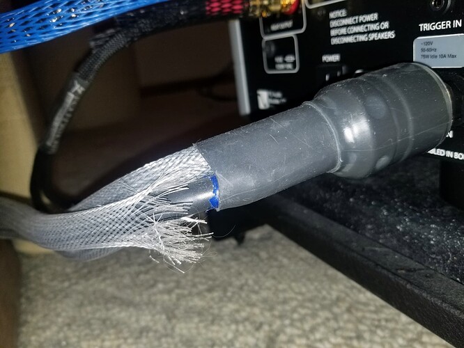

I have an older power cord that needs a little attention. The heat-shrink tubing has pulled away from the outer sleeve, exposing the insulated wires. The only option I think I have, is to remove the plug, then replace the heat-shrink tubing, then reinstall the plug. Was wondering though, if it’s possible to slice the tubing, in order to avoid removing the plug, then heat weld the seam as I’m heat-shrinking the tubing. I’ve never worked with heat-shrink tubing before. Trying to avoid having to remove the plug

If you experiment with a piece of standard heat shrink, you’ll see if you split it, it will not stay joined. However, there is heat shrink that has glue on the inside that “might” work. But, to be honest I don’t thing that will suffice either.
One of problems is, the heat-shrink on one of the two identical power cords, is too short, and now the outer sheathing has pulled out, and is unraveling.
I think you can purchase 3:1 heat shrink that will fit over that connector and shrink down enough to be tight over the areas that are fraying.
My suggestion, buy some, and test it without putting it around anything. I am pretty sure it will shrink enough for your needs.

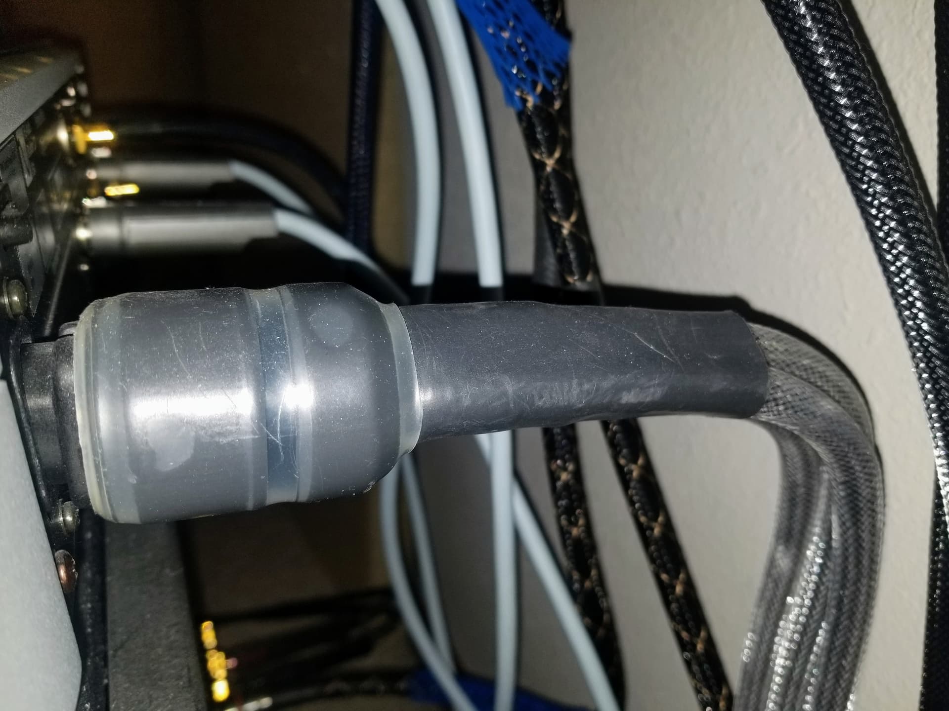

Unless I am missing something in the photo, I wouldn’t remove the existing shrink. I’d cut a piece big enough to overlap the exiting shrink and cover the fraying area plus a bit extra, maybe 5mm or so extra, and call it good.
In the pic, I don’t see damage to the existing shrink.
However, if you are going to sell the cable and want it all neat and tidy, then I would gently score without going through the shrink from the connector down to the end over the cable. I would then at the connector end carefully cut a 5mm or so section all the way through, possibly with an exacto blade by slipping it underneath the edge and cutting upwards. Once that 5mm was cut through, I’d try a pair of needle nose to see if I could then peel the shrink away from the connector and the cable.
If the shrink is glued, this is more difficult, but in some cases doable.
Wasn’t planning on removing the existing heat-shrink, just going to go over it.
Probably wasn’t clear. My plan was to slice the length of the new heat-shrink, because I didn’t want to remove the plug. If I can find 3-1 heat-shrink, I should be able to slip it over the plug, then shrink it tight.
