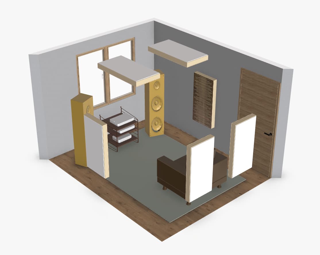

The people at GIK have been very helpful and I think they make good products at a reasonable cost. They proposed the following design as a start:
This seems like a plausible first step…however I am wondering if I should prioritize addressing bass control in the corners? I’m also unclear on whether I should be focusing on absorption or diffusion, or a combination of both?
GIK offers a pretty wide selection. Some panels focus on absorption. Some focus on diffusion, and some are a hybrid. For example the 244 can be ordered with a scatter plate to provide diffusion. The Impression and Alpha panels have wooden surfaces with various patters in them to provide diffusion/scattering. You can do this with their corner tri-traps too! All of the various options can get a bit overwhelming.
Any advice on the best first step to make would be greatly appreciated.
