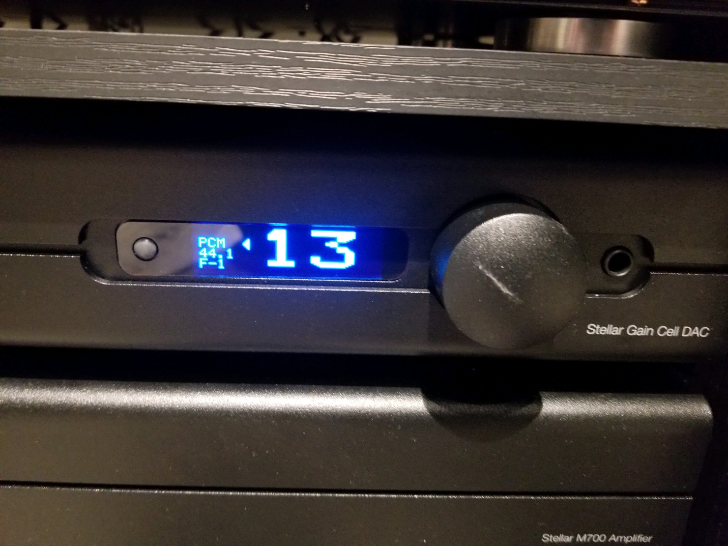

jhsg…Yes I also saw threads about this issue after I bought my SGCD in April 2020 and had this issue right out of the box. I wrote several emails and made calls to PS Audio and in my case perseverance has seemed to work. The fix has worked and there is no more pop or hum when switching to the HT mode but it had taken six months to drive the point and at a cost of a blown Beryllium tweeter on a Focal 1028Be speaker. That also took 6 months to get a replacement from Focal. I am sorry you had sell your SGCD I would have also in fear of damaging more expensive components.
I wrote an email to TJ copied jamesh and Paul on 10/26/20 letting them know that my issue was resolved on the SGCD and thanking them. Problem is when the SGCD came back there was a huge visible scratch on the volume knob and that the knob was loose. It no longer has that tight liner feel(click, click, click) to it and is sloppy and asked if a new knob can be sent of if I should send the SGCD should be sent back again. To date I have I no reply back. SGCD Knob|666x500](upload://ahkZDH8b3gOYvjIf5qvumcSpN18.jpeg)
Good to hear you got your probably solved but that scratch!! WTF!!
Yikes! I’ll ping TJ and James for you.
Nothing a black Sharpie can’t fix, right?.. I’m kidding.
You’ll be hearing from TJ via email later today. Instead of bringing the whole unit back, he’s going to send you a new knob with instructions on how to replace it. It isn’t terribly difficult.
