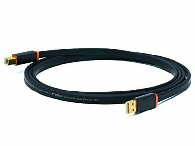

For USB Curious Cable seems to be a popular choice though I am quite satisfied with my Oyaide USB cable.

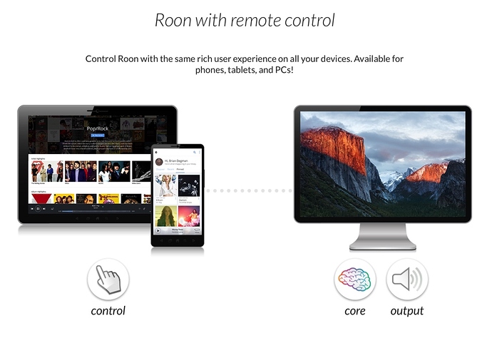

In figures, the simpelest and easiest to use(remote controlled) Roon configuration published by Roon:
The computer (iMac as example) runs Roon Core, the smart devices are your remote and you can connect that computer (iMac as example) with an USB cable to the Stellar Gain Cell DAC. Now the iMac in this picture could be replaced by the Roon Nucleus, same thing, only has no screen (doesn’t need it as you can utilise the remotes) which you can connect also with an USB cable to the Stellar Gain Cell DAC.
Now if the iMac already sounds good, the Roon Nucleus dedicated Audio server should sound even better.
