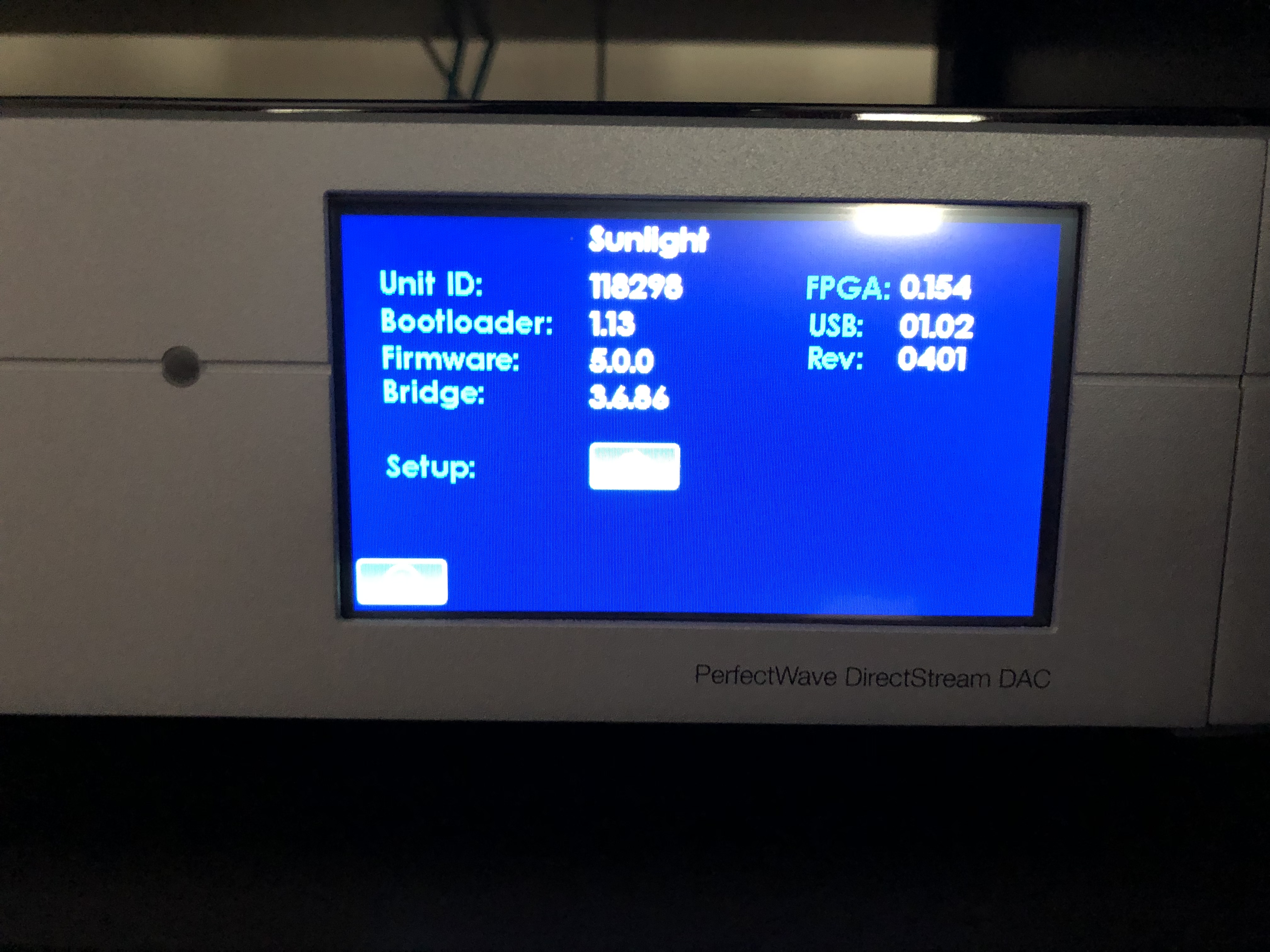

Here are the version numbers after upgrading!
