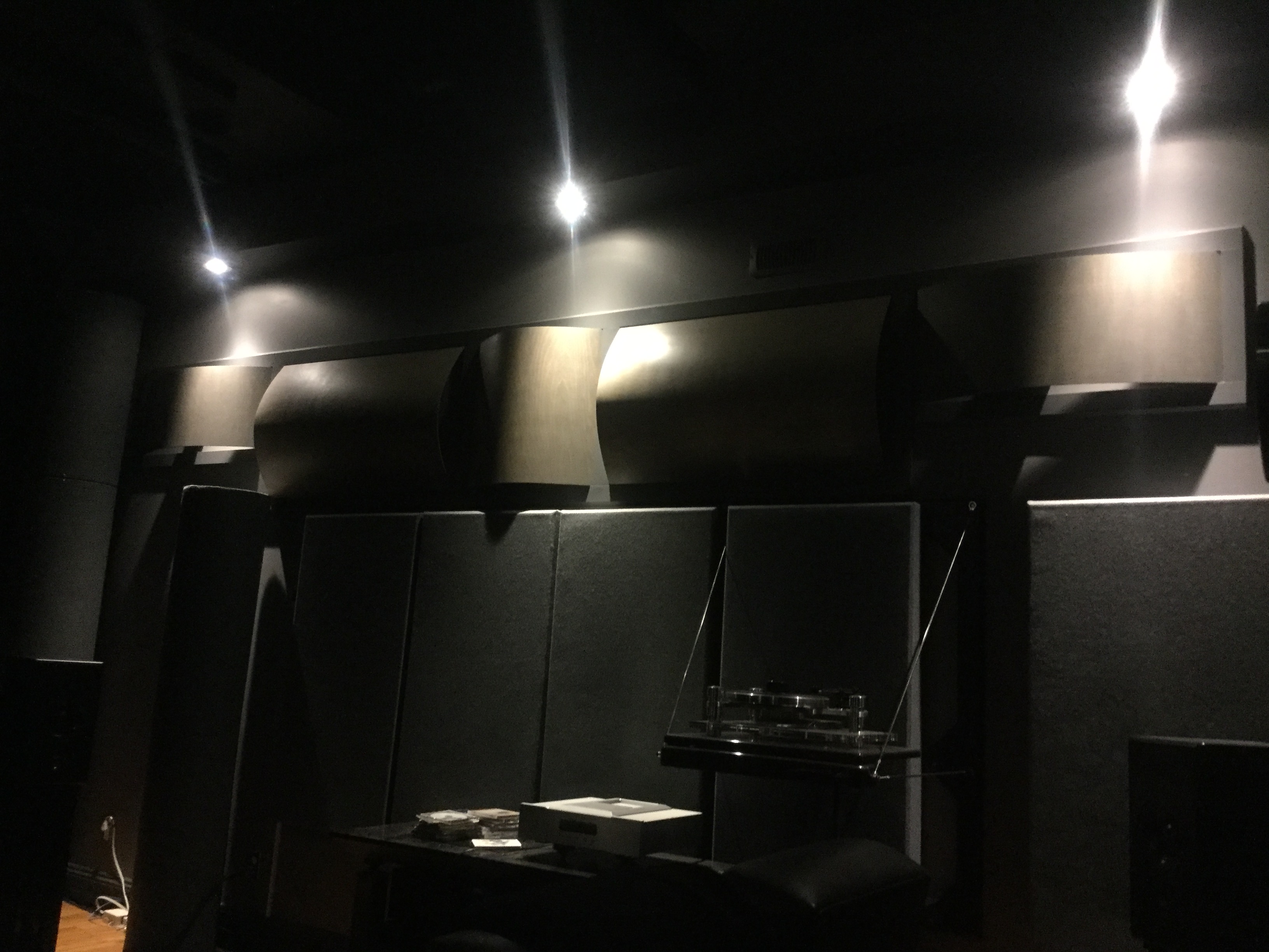

My room irregularly plays host to guests that share my passion for music, but for movies and gaming nights, you must beat them back with a stick! In answer to your specific question @joma0711, the room is very quiet. Spoken word clarity is excellent and while the room certainly sounds very different than the much more reverberant spaces we normally live and work-in, it is in no way acoustically uncomfortable or “dead” sounding.

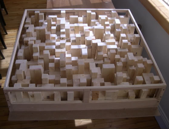

While there is a significant amount of acoustic treatment in this room, what there is still only occupies about a third of the room’s surfaces, even if you count the carpet. Treatments are divided up pretty evenly between diffusers and truly broadband absorbers. For example all the tube traps have their curved reflective surface facing into the room so they behave as diffusers from about 500Hz on up. So the Tubetraps along with all those wooden poly-diffusers (particularly on the upper walls) prevent slap echo without any loss of acoustic liveliness. The big square grey “trap” on the rear wall below the projector? Not a trap. It’s a diffuser too- a 3’x3’x9" deep fabric covered “skyline” 3d quadratic diffuser.

It would also be worth noting that when I added multi-channel capabilities to what was once a dedicated two-channel space, you end up requiring additional broadband panels to absorb the primary reflections from all those additional loudspeakers. Were this room two-channel only, three of the five panels rearmost running down each sidewall would be redundant.
thanks for the detailed answer - it sounds like a good combination of live and not - well controlled :slight_smile:
just needs a mixing desk and a separate recording space with a video link and you’re in business :wink:

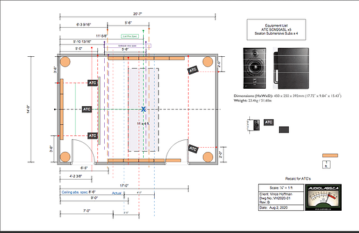

I just noticed the door hinge under the acoustic panel! Very stealthy on the door! By the way I’m still working on getting CR-1 for my system!
Yeah, that panel is actually pictured on both the newest CAD line drawing Jim at Audiolabs created for me along with the original from 8 years ago with different gear. Actually almost all of the current room treatments go back to my original work with Jim 8 years ago when I was using larger floor standing Meridian active DSP loudspeakers fronted primarily by Meridian electronics. After running some ray-tracing speaker and treatment optimization simulations on my room again along with critical listening and some tweaks suggested by Room EQ Wizard measurements, it turns out the new gear works even better in pretty much the same spots.
