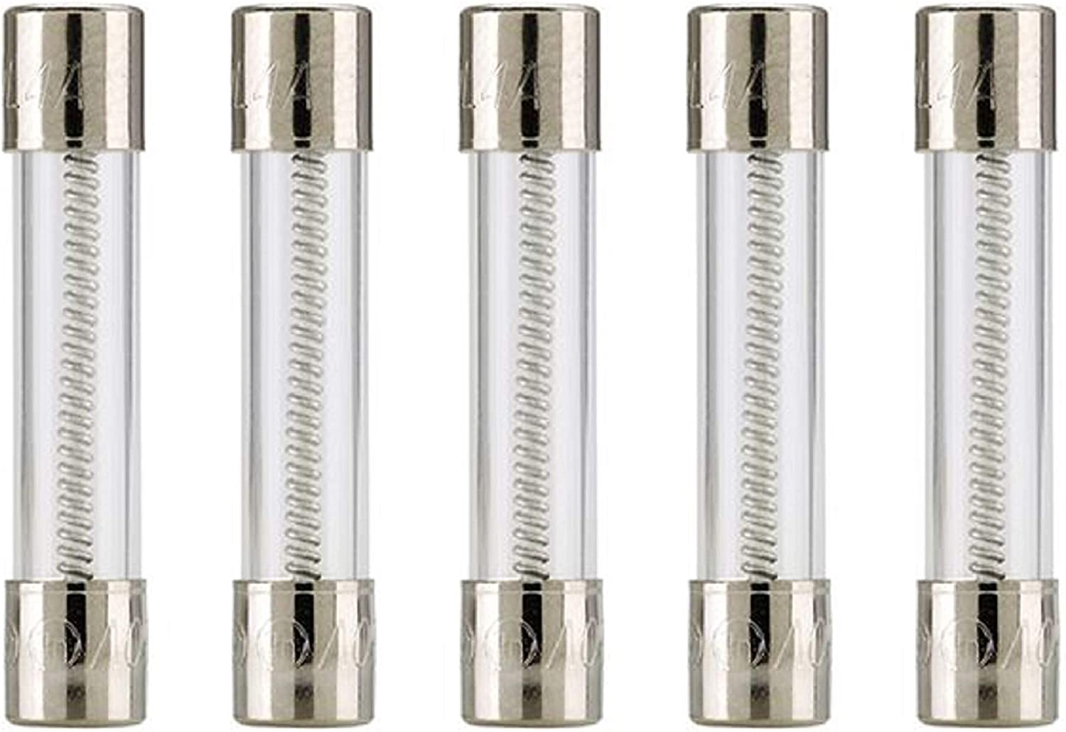

Without a magnifying glass would be hard to see. If in doubt just change. If you can’t find local these should do it.
Happened to me a while back as well. Had to check the fuse with a multi meter because the fuse has a ceramic body . If you have trouble getting a fuse I have spares and I could send you one at no cost. Just PM me your address.
Tom
Huh…those look nothing like the fuse i took out of the P3
Duh
Its the same once i removed from holder
If you don’t have a Radio Shack type store where you leave then someplace that sells and repairs guitar amps should have a collection of fuses. Never checked Walmart but they might.
