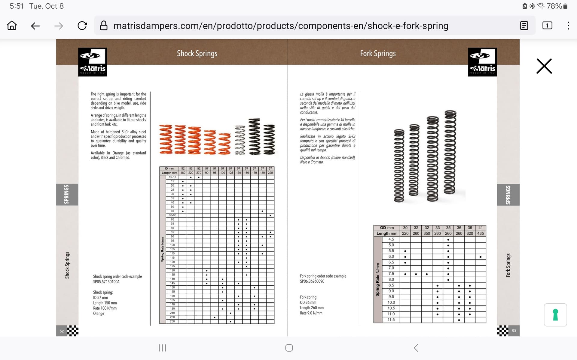

OK, got the Matris F15K forks installed. The crazy Italians keep changing stuff for the better, but the directions are out dated! You can figure it out but…? So only one, not two, plastic spring washers. And the lower compression piece is no longer needed as the F15K damper rod is machined to that fit. The silk screen on the top of the forks is nearly invisible but once they are on, you know right is rebound left is compression.
I used 6.5 / 35 mm diameter springs (see chart) and 15 “clicks” of compression and rebound with six rings of preload. 5 weight fork oil.
The ride is far better than the emulsion forks even though the fork pump at a stand still feels near the same. Moving? Not the same at all. More bumps aren’t bumps. Less shudder across multiple jumbles of irregularities.
I’d say for the money the Matris F15K was worth it. Pretty easy to install once you get past the lower allen screw that holds the damper rod in place. A vise and a 1.5 foot cheater bar got it done. The first leg was 1.5 hours with one hour being “discovery”. The second was half an hour. No stuff is modified so it can all go back to stock.
If you have emulsion style forks, this is a decent kit to get true cartridge design with three way adjustability. Just be true to how you use the bike and don’t ask for “race” suspension because the Italians mean business on that end (stiff). I expressed COMMUTER suspension and 150 pounds. It feels great.
