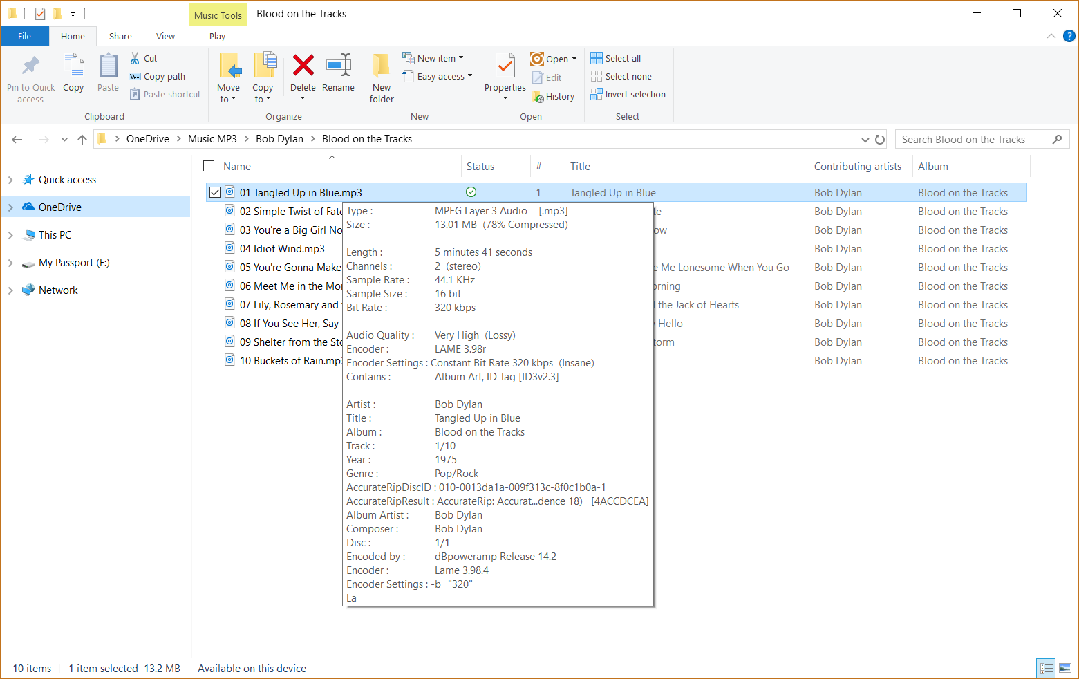

Here’s MP3
Notice: Roon changes sample size from 16 bit to 24 bit
