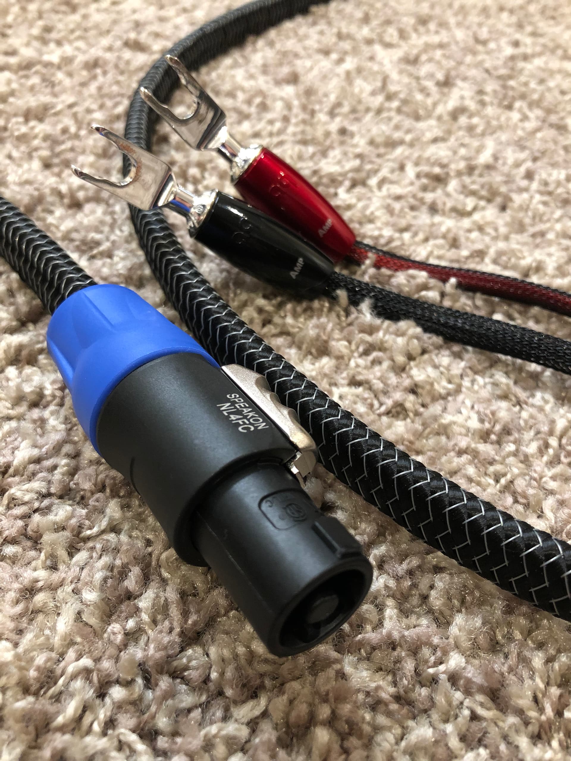

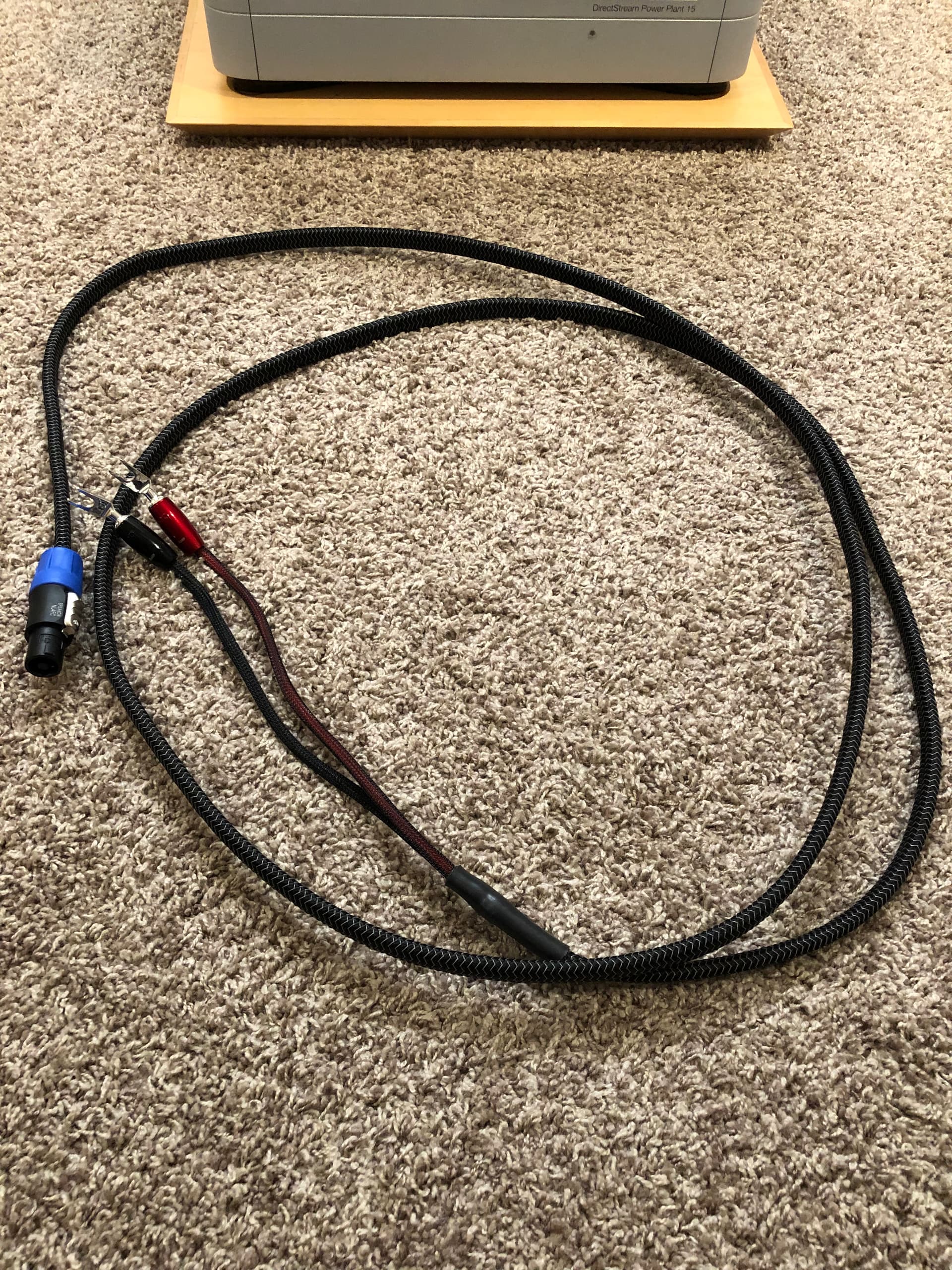

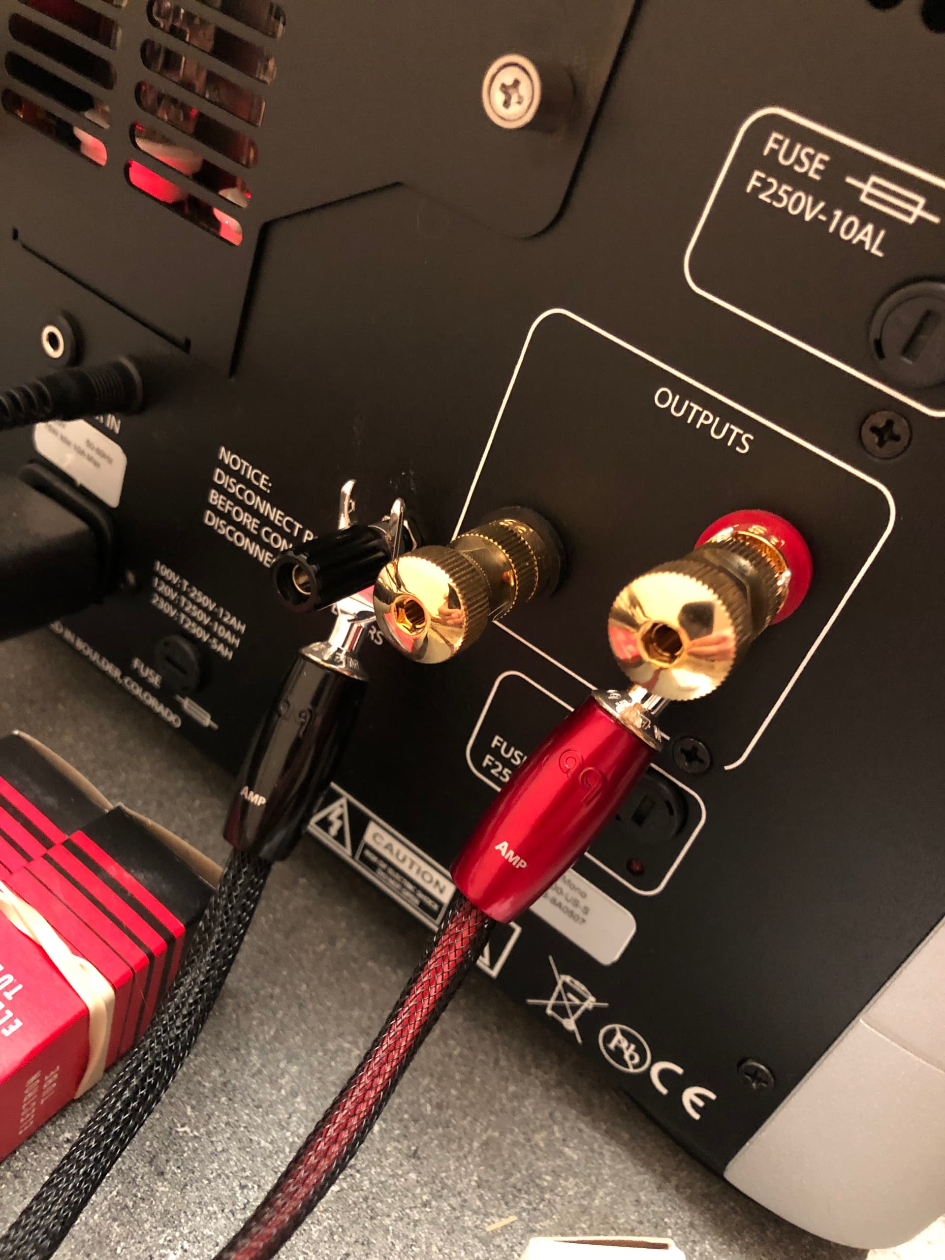

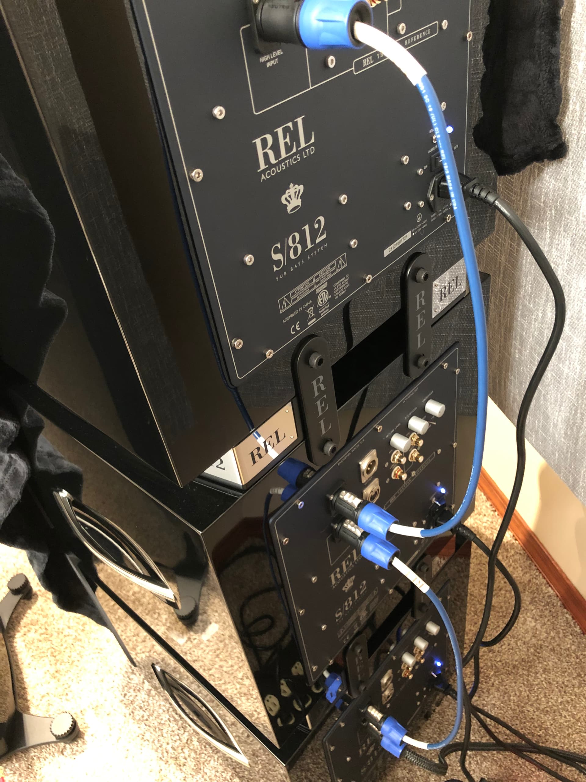

Here they are. I use the BHK300 so different setup than usual REL cable guideline.
FYI I am using the REL Bassline Blue connections for my six packs so it is a hybrid cable setup. Will BJC be offering those as well? I’ve used BJC products in my theatre room.
Great images and beautiful REL subs. Let it be known, that the cable assembly is not the “recommended” by REL configuration and is different from what we would be sending. Is there a jumper involved?

Great Sub stack. A properly set up 6 pack is a revelation. Have you ever experimented with replacing the stock power cords and fuses?
My dealer will be visiting to discuss power cables once the subwoofers are fully broken in. Many new components in the chain right now. All cooking well so far.
