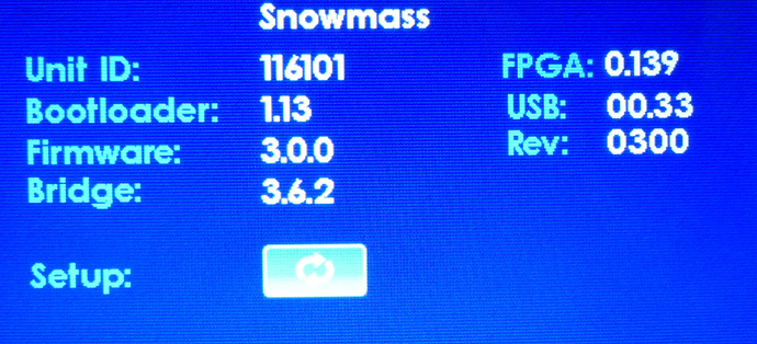

@Paul - Easy Peezy - PSA DS DAC Front Panel Bridge II Update from 3.6.02 to 3.6.17
  1. Downgrade PSA DS DAC from snowmass to redcloud - successful
  2. Upgrade Bridge II from 3.6.02 to 3.6.17 - successful
  3. Upgrade PSA DS DAC from redcloud to snowmass - successful
Upgrade Progression
I downgraded my DS to redcloud but my bridge is still reporting 3.5.1, with a message saying firmware is up to date. I didn’t get any option to upgrade. What am I doing wrong?
I may have gotten my self in trouble… I tried the mconnect method and more than 5 min has passed it still saying firmware update start…
Is the red progress bar visible on the app? If so, try giving it some more time . . .
I love the sound of the new Bridge II upgrade through Snowmass. Thank you.
@falling_leaves - initially it will say up to date. It took my upgrade a few minutes to recognize it needed upgrading. However, I did not re-cycle the PSA DS DAC power, just tried to be patient. The coffee needed attending so it gave me the time.
I got it finally. Apparently the mconnect update didn’t do anything. I waited 15 min and still see the firmware update started message. I decided to take the chance and power cycle, luckily no update took place and this time I get the new firmware notice, updated via that method works perfectly. I’m good now. Thanks so much.
