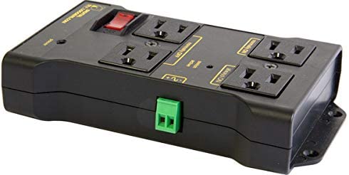

Enter the “Iot Relay - Enclosed High-power Power Relay” this $27 device takes the 12v trigger from from my P10 regenerator and uses it to switch “off” the charging of the battery pack when the P10 is turned on. This removes the walwart from the sytem. When I shut the system off the charging to the battery pack is resumed. The Relay unit can do this for two battery packs. One on each outlet.
The unit can be purchased here.
